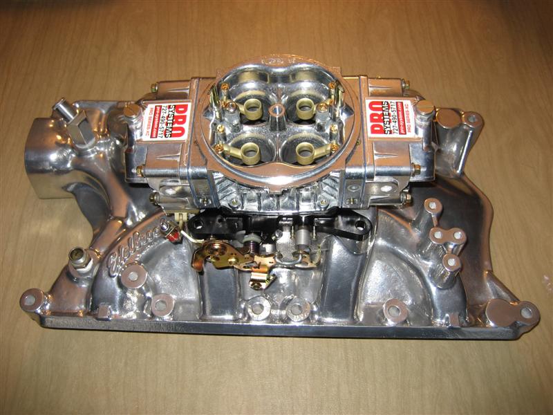

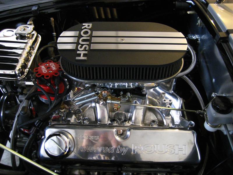

When I had my intake off last winter I smoothed it down and had it Ceramic coated. Looks great and easy to maintain with glass cleaner and a more detailed cleaning with aluminum or ceramic coating polish.

that ceramic intake is very nice !
