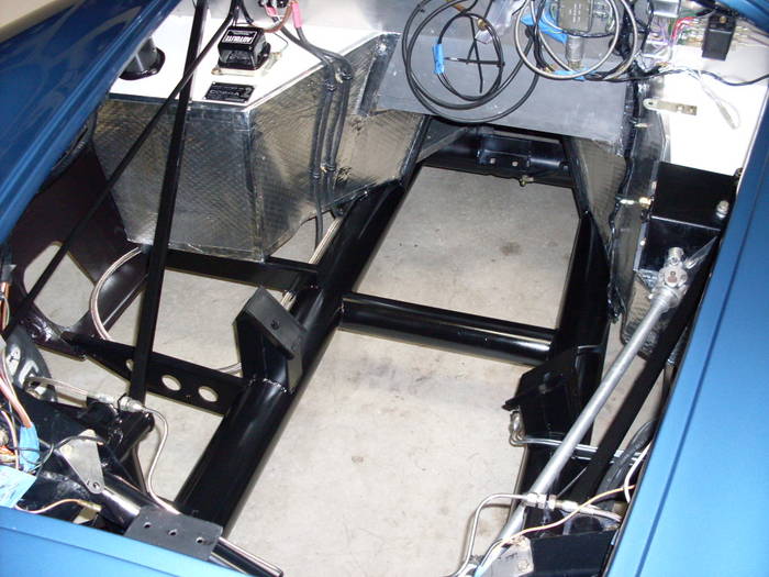

Well Tuesday the engine and trans went in and now Rob will start on the headers and side pipes and I'll finish all the other stuff...Getting closer

Yes finally cooled off in Dallas and much more enjoyable working on the Cobra now. The car is a Exact Cobra made with Carbon Fiber built by Roger Bolick in Austin, Texas. There has been several posts about his cars over the last 3 years especially with the red one Double Ugly built. The car is a perfect replica of a CSX and I would say if you had a Shelby ID label on it you wouldn't know the difference other than the quality of his car far exceeds the CSX4000s. He built and sold 10 cars and is building a new demo car right now. His focus has been to design and manufacture more of the parts he uses and start making large quanities to build another 10 cars and also sell replacement and improved parts to Cobra owners. For you CSX and Kirkham owners out there.....check out the 4 bolt motor mounts he built that are on my car in pic above. He is going to sell those as an example.
