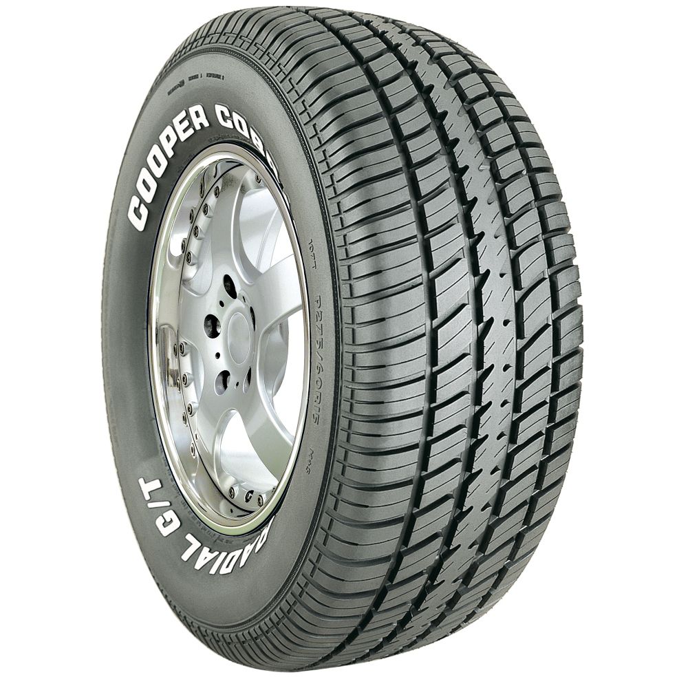

Cooper Cobra Radial G/T
Mastercraft Avenger G/T (a Cooper Tire brand)

I have used the Cooper Cobra radials on my roadster since it was built and love them. I also tried a set of Goodyear Billboards and hated them for several reasons which I will not go into here abd went back to the Coopers. First, the Cooper tires were available in the proper widths of 15" for my car. Second, the cost was quite reasonable compared to other brands, and third I kinda liked that they said COBRA on the sidewall and had a cobra snake as part of their logo. These tires wear well, provide good traction, and handle and drive great. For a street only car they are ideal in my opinion. I can't see why I should pay a lot more for another brand.
