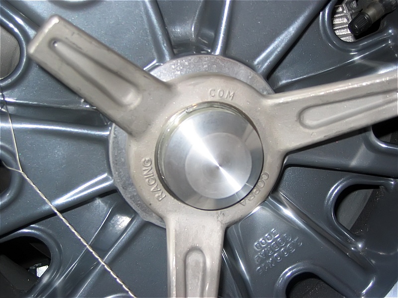

Torqued my spinners to 65 lb-ft. Haven't moved in 3 yrs according to the safety wire. I check them before every drive.
I would feel a bit uneasy about leaving wheels on for that time and I would definitely use anti-seize.
I dont see the point in the leather on the tool all that does is soak up force and feel, the spinners are forged 6061 T6 the spinners should handle a snug well designed tool twisting on them. Good idea to avoid excess damage to the spinner.
