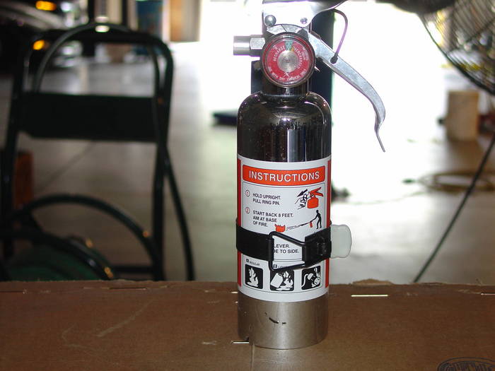

[IMG][/IMG]
You are absolutely correct about an extinguisher in the car art all times. I did not have flames (and have no idea why not!). This gasket on the remote filter adapter was improperly seated and let go at triple digit speed. It looked like the smokiest F1 blowup you have ever seen. I looked in the mirror and could not see anything! Oil was ALL over the bottom of the car, but luckily didn't get on the tires. I dodged a bullit much like Hemisnake.

Hemisnake, I'm glad that you are ok. We always encourage our customers to get an extinguisher. Here is the one we sell. If anyone is interested we sell them for $50.00 + Shipping

What can you tell us as to what these fire extinguisher use for their fire suppressant ingredient? I have heard, which I can't say is totally factual, is that some chemical based extinguishers are very corrosive to electrical components. That is why some fire suppressant applications are better off using halon, which in an open car may have a difficult time starving out the oxygen in the air. I realize that having some corroded wiring is a small price to pay when considering the total loss of a vehicle. I would just like to know before hand what type of product I would be using before purchasing one of your units. Thanks!

Halon is being replaced by another product these days....I don't remember it name right now...(Halotron I think)
Any cabin mounted fire extinguisher should have metal not plastic attachment hardware. Most tracks don't allow the plastic hardware....
Standard chemical fire extinguisher's are a disaster in a car fire, the fine powder (Sodium Bicarbonate) gets into everything.

Short on doing a thesis on this, you are correct. Wiring could be corroded and your aluminum car would be at risk. Monammonium phosphate and Sodium Bicarbonate have corrosive properites, but under the circumstance of a fire I'm persoanally not concerned at the time of corrosion. I think in an open engine compartment fire you will have a better chance in smothering the fire with an ABC type. Halon type you are exhausting oxygen, if you can't remove the oxygen, or heat you will still have fire.
You will also have all metal hardware for the attachment of this canister. I'm really not an expert on this but have been around enough aircraft and know that both are used.
