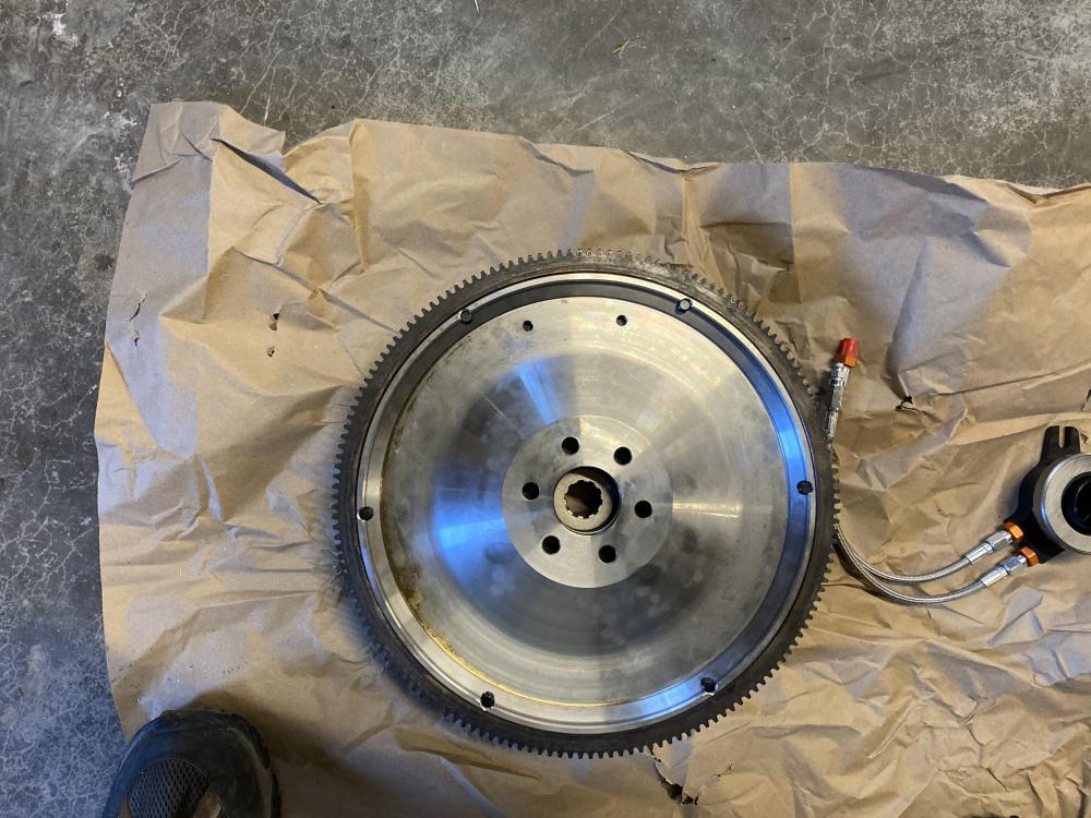

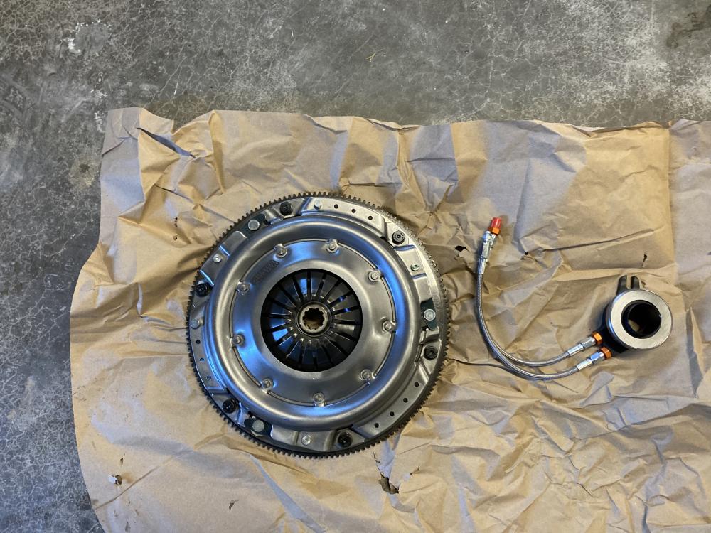

Greetings,
Well, my Quarter Master clutch, HTOB and steel flywheel arrived yesterday, along with a new Lifeline fire system. The clutch, flywheel and pressure plate arrived all bolted together and since the engine is going out for a refresh and it was freezing in the garage, I decided to use leave it altogether for now.
They looked nice nd the HTOB has a nice feature in that there is a locking stud that prevents the HTOB from spinning on the shaft during install. My McLeod does not have that capacity and the HOB's do spin a little when you are trying to line up the input shaft with the bushing and bolting the transmission to the bell housing. Always wondered if my depth was correct after the transmission was installed and there was no wy to get a micrometer in there.
I did test fit the assembly on the input shaft to make sure that the correct disc was in the package and it slid on nice and tight (but not too tight).
Jim
