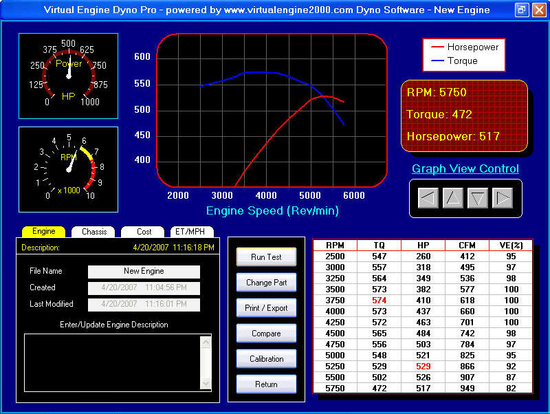

Thanks for the neat dyno graft. I will "uncork" this stroker beast ASAP with the use of deep breathing heads, lg single pane intake and large duration roller cam as soon as possible.
