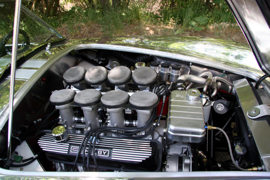

Old 04-27-2010, 05:05 AM
Join Date: Nov 2007
Cobra Make, Engine: KMP532, KC427FE, TWM
Posts: 310
Picture of you TWM/FAST system.

Old 04-27-2010, 11:21 AM
Great Asp's Avatar
Join Date: Feb 2001
Location: St. Louis, Missouri, MO
Cobra Make, Engine: SPO 2715
Posts: 1,648
How do you like the system?
