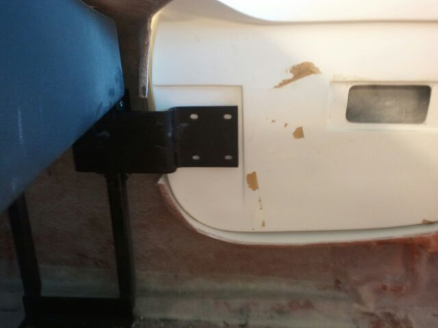

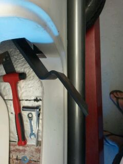

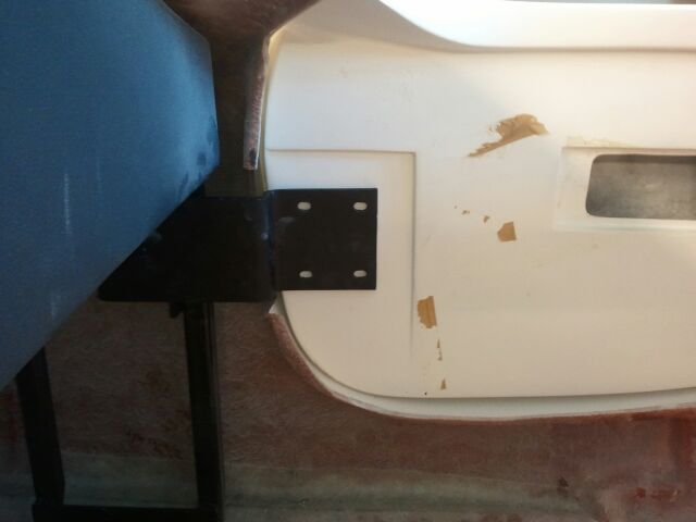

Picture of hinge swing attached to rear post
Picture of hinge position on door with hinge attached to rear post
Picture of hinge swing attached to front post
Picture of hinge position on door with hinge attached to front post
Front post refers to engine compartment side and is where plans actually show attachment.....rear post refers to cockpit side.

Your 2nd and 4th pictures look identical.

Look closer and you will see the gap is bigger between the end of the hinge and the crease in the door in pic 4.

Actually, if you look closely at the extended hinge pictures you will see that in either position it will only go so far until it hits either the post or the body, so, it seems like the hinge could be mounted in either position, but, can it actually? That is my dilema, do I mount it like the manual says or do I go rouge and mount it the "EASY" way? Wondering wht the consequences of doing it that way will be? Obviously the door will open a little further but are there down sides to doing it different than the maniual? Has anyone done it?
