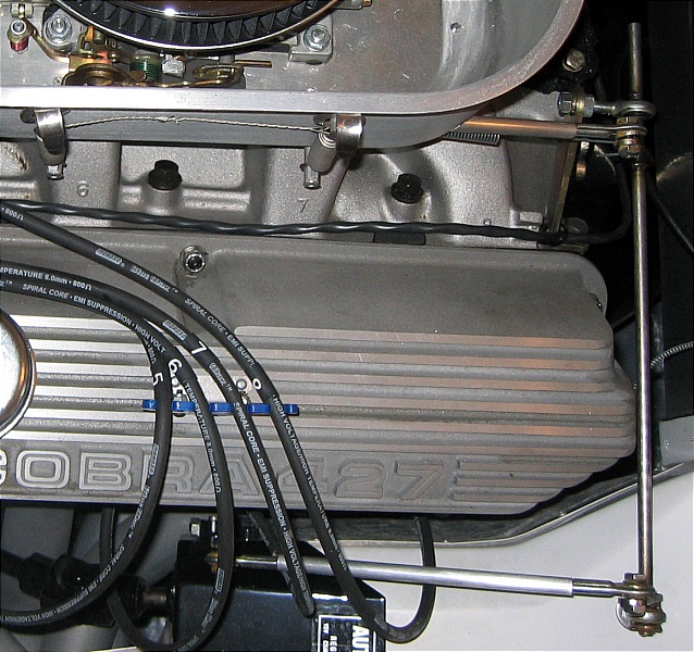

The metal piece that wraps like a 'U' around the throttle linkage rod had slipped and settled on the rear side of the linkage. Kind of hard to explain.
I don't understand. Here's a pic of my linkage, which I know is a little different than yours. Is that little 'U' piece visible here? If not, would it be in the upper left corner, right corner, lower left or lower right??

Pat,
Lower right corner. The horizontal linkage connects to the vertical rod via a 'U'. At least that's how it is on both cars. The 'U' has a nut and bolt. If it's not tight enough, it can slip on the rod. When I say 'U', I mean it wraps around the rod.

Pat,
I'd post a pic but we're leaving for vacation. I'll do it in a week if anyone is still interested. LOL.
Please do. Here's a diagram of the ERA throttle linkage, FWIW: ACCELERATOR PEDAL AND LINKAGE

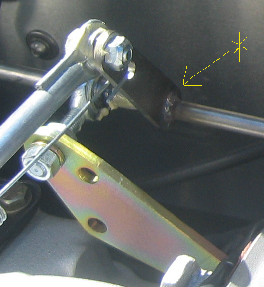

Originally Posted by rodneym
Pat - What I called a U is really a J piece. And it doesn't wrap around the rod. It folds with a nut and bolt, pinching the rod....
If this is the piece we're talking about, and it's held on with a J-bracket and pinching nut, then I'd get it aligned just right and weld the damn thing. It's not like your ever going to change it. That's just not a good way to have it attached, IMO.... Yeah, yeah, yeah, I know... that's how they did it on the original cars... but give me a nice weld any day of the week for something like that.  The last thing I need is a stuck WOT -- I have doubts whether I could think fast enough to react before I was dancing with the angels....

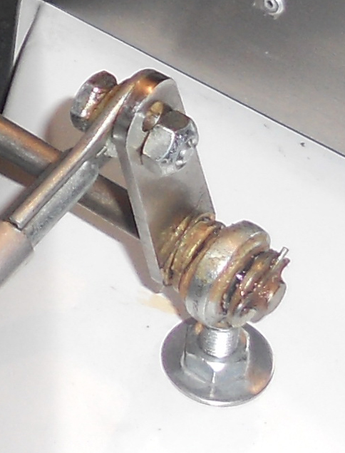

... and likewise on the footbox end of the rod.
