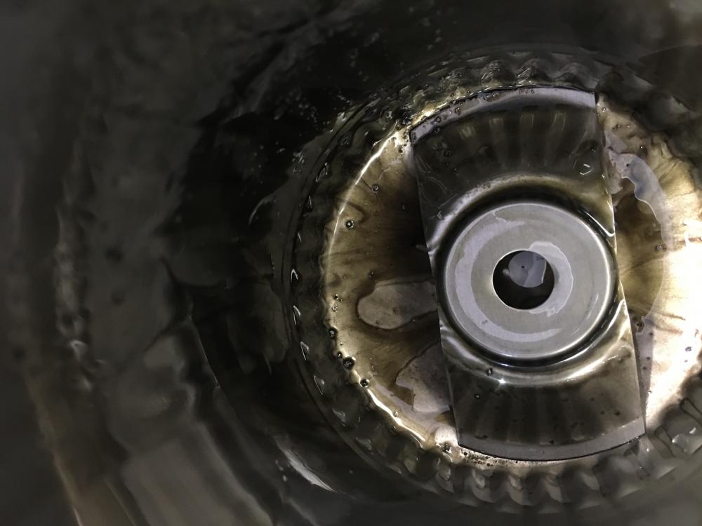

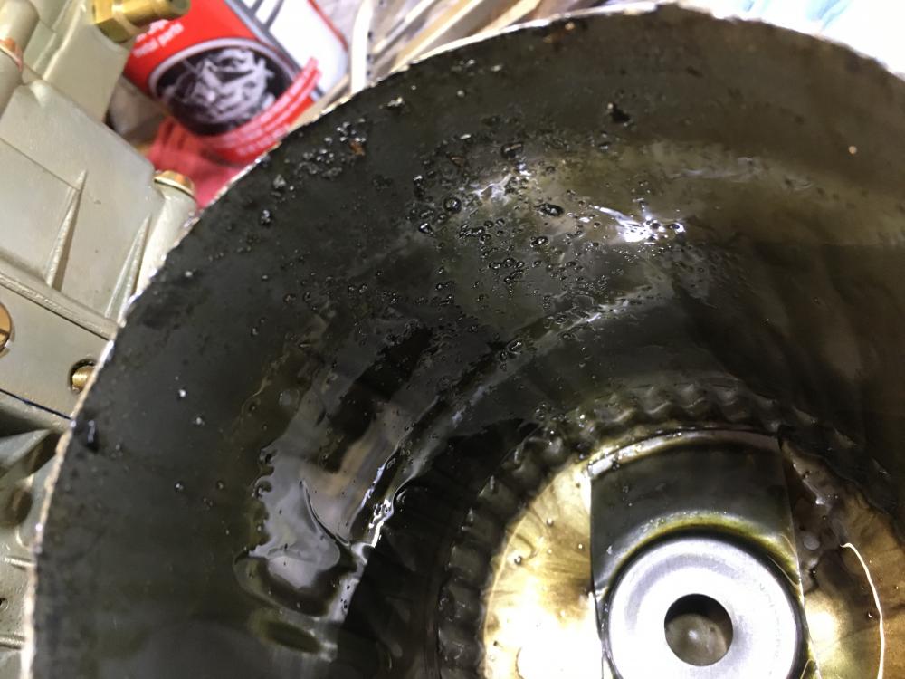

Open the filter, see what you have going on in there first. It takes 5 minutes.
There was a fair amount of grit on the side of the filter housing and some on the bottom. The paper element had a bit too, but not as much.
http://www.clubcobra.com/forums/pict...ictureid=16627
http://www.clubcobra.com/forums/pict...ictureid=16628
blykins 05-30-2017 08:31 AM
How did you cut it apart?
Got pics of the element pleats?
dcdoug 05-30-2017 08:53 AM
I used a dremel around the lip. These pieces seem bigger than any filings that I might have created using that method.
Pleats were pretty clean. Found a few small particles only I'll try to take some pics.
