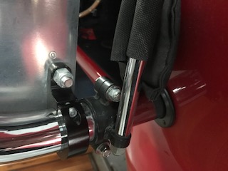

Here's an option for the head restraint, I wanted one that was removable (mine uses UTV clamps), and wanted it to follow the outline of the rollbar hoop shape, I just like that look, blends in nicely in my mind. 3/4" plywood, 1/4" aluminum backing, plus 2" proper high density rollbar padding makes it pretty bomb proof.
Mark

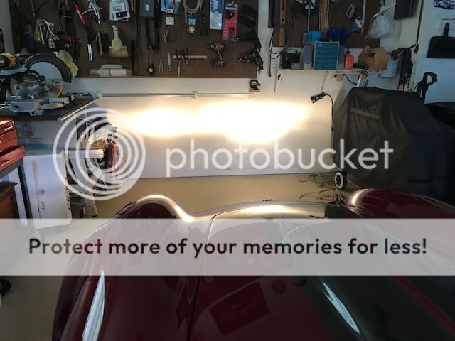

Got the Hella Super 7" lights, installed the right light and flipped them on for comparison. The camera doesn't show the relative brightness - the new light is brighter even with the Hella standard H4 bulbs that came with them. Can see the flat top of the pattern compared to the sealed beam in the first photo (low beam). Of course, a wall just a few feet in front of the car isn't a valid test, so will make a night drive before deciding if I want to get the Performance plus 50% bulbs. They're brighter but have a shorter lifespan. In the second photo (high beam) can see the new light is significantly brighter and broader pattern as well - again, the camera tends to even them out - the difference is more than the photo shows.
"Anyone who drives faster than you is a maniac and anyone who drives slower than you is an idiot" - George Carlin
"he camera tends to even them out - the difference is more than the photo shows."
Yes, the difference will be more than the photo shows, because the human eye has far greater dynamic range than a digital sensor.
In photographic terms you've blown out the highlights. Once the sensor can no longer pick up any more light it doesn't matter whether it's 1% or 100% brighter than the sensor can handle.
A better comparison would be dial back the exposure until the camera can actually show the difference. If you really wanted to get fancy you could shoot a series of shots at different exposures to see a better comparison yet.

Thanks for the photo tips. I've already installed the second light so hopefully the photos I posted have some value in showing the improved pattern. Because of my lack of photography skills, everyone will just have to take my word for it that they are brighter.
I'll post again once I've aimed them and gone for a night drive.
