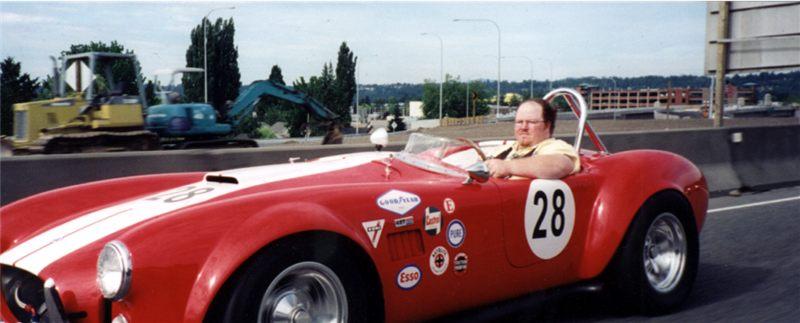

Here's me on the highway last year with the racing screen on.

How tall is that? Thickness?
I'll make some out of lexan, if you guys want. Any particular features? How thick would you want them?
I need to make a couple for around here anyway. Any I make right now will be one off, so this is your chance for custom windshields. If anybody wants a lexan version of a cracked plastic one, send me the broken one. Or send me some specs. I've been itching to do this for a while, and now I have an excuse.

......................why is George Costanza driving Brent's car?
Inquiring minds want to know!

Oh man, thanks Rick!
I was kinda dissapointed because I could have sworn the cobra restorers catalog showed the reinforcement. I would prefer something along those lines.
