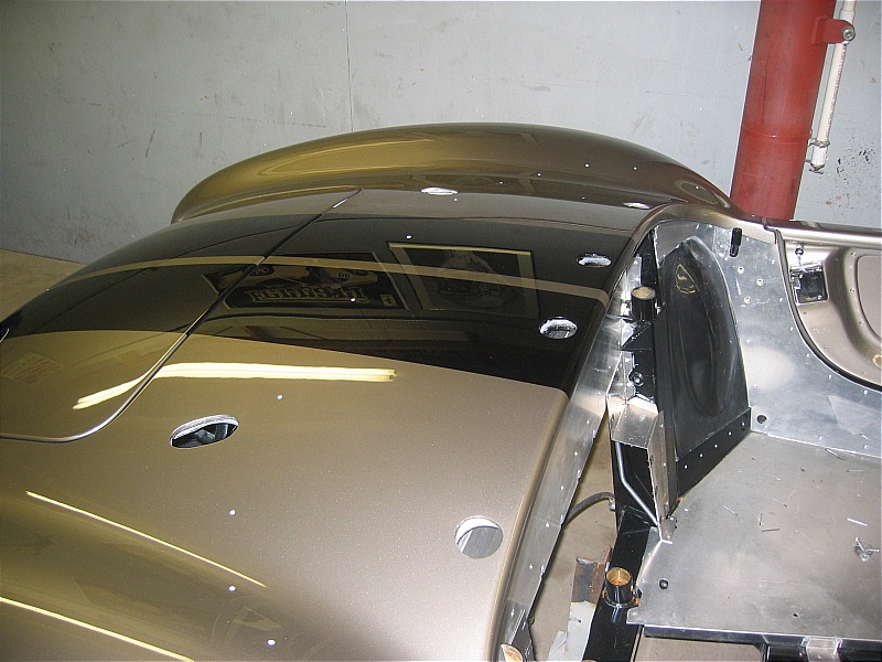

I've seen first hand that ERA's roll bars are functional on the 427 body style. Add them to the list.
For those that are interested, here's how they mount:

Now don't anyone say that Patrick doesn't go out of his way to help people out.
Taking his car all apart just so we could see his roll bar mounts.
Well, ERAChas promised that he would put it back together for me so I've left the light on in the garage for him.
