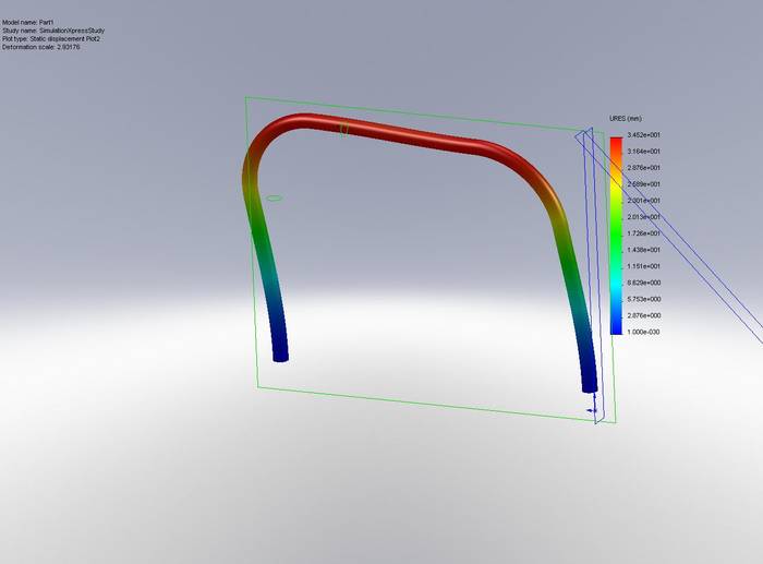

Does anyone have an opinon on whether dual roll bars are structurally superior, or inferior, to one full-width roll bar?
If all the mounts are equal in strength, my bet would be the duals would be stronger. 6 mounting points vs. 4.
