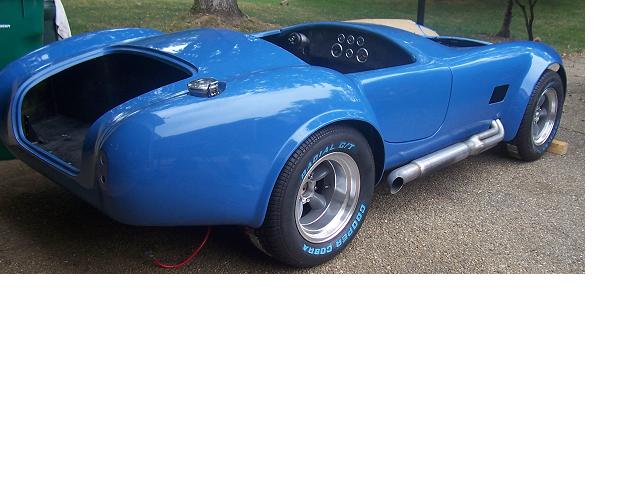

roll out with doors on

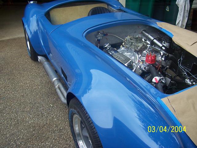

Looks really good. I love those wheels...keep up the good work and keep us updated.

Looking Good! Took me a couple hours to hang the first door, the second door took 45 minutes  Great progress & love the color too. Keep posting updates

Hey, just getting the doors on is a feat in itself. Car looks great.

Hey let me tell you I loved every minute of my ac auto cobra build and yours is lookin awsome to, great job . It all pays off in the end. Looks like ZAT blue to be I love that color. TIP go to Harbor Freight and get yourself a box of body shims for like $6 they come in realy handy with the doors and front wheel allighnment. Awsome pictures!

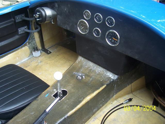

Great Job!! I was noticing your hole for your shifter. Mine started out about that size and I eventually found the hole was limiting me going into 2nd and 4th gears all the way.

You copy cat, you stole my wheels, great choice bye the way. How about the spinners!

Cut the cowl bar in half   didn't get that bad but I did grind a little metal off the hinge bracket before I realize I was upside down.  I know it needs those spinners. Anybody get theirs from the ebay dealer out west seems like a good price $100.

Instead of using a muffle type clamp for the steering wheel bracket on the cowl frame. I can't see how to tighten after the dash is mounted. I might use threaded rod with the brackets from the muffler clamps. This way I can loosedn the steering coulmn from under the dash. I try to take some pictures.

I used an Ididit non-tilt column. I used their Gimbel mount on the firewall and made a sleeve mount that bolts on the top of the footbox. I did not use any of the A&C hardware on the cowling.
