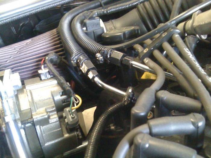

1. How does one connect to the 3/4" male thread on the Mustang 302 EFI supply and return pipes? I'm running rubber 3/16 efi hose from a stainless barb on the end of the hard s/s lines and cant find a fitting to join hose to the threaded end.

Greg, my 302 had the normal key-lock connectors but I attached the fuel lines with brass connectors from a guy near Warwick's place and covered them in some protecting tube - you can see the connectors here, however. They had a huge array of brass connectors. No leaks and all seals fine. Not sure if you have a flaring tool.

The fitting on your fuel rail looks like a 3/4" JIC male. This is a very common hydraulic fitting. I would be going to the nearest Pirtek, Enzed with the barbed fitting and have them silver solder a 3/4" JIC female to it. Hope this helps.
