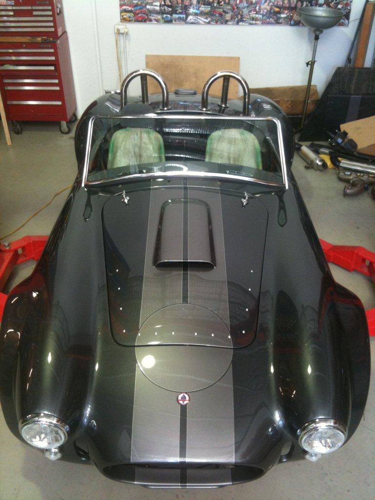

Starting to take shape...most of the outside stuff on...seats fitted...happy so far.
I'll get stuck into it for the next few weeks and then I'll post a couple more if anybody is interested.

Looks great, what's holding that front wheel on Wazza? Are the seats from Harrison or from another supplier? Love to see more pictures a little clearer so everyone can see the good work!

The wheels are currently held in place by "Fresh air"....and a rubber band under the tyre to stop it rolling away !!!!
Might need more than that...right??...I'll work on that.
The seats are a flop from a mold owned by one of our members...Steve Barbe.. I have the same seat in my race Cobra.
I think it's originally a seat from a VW Beach Buggy.
I Liked it because it "lays back"...i.e. a lot of the fixed seats are made with an "L" shape...with the back at 90 degrees to the base...these are more laid back, and are not only really comfortable, but help get your chest back and away from the steering wheel.
Often see this type of seat in Cobras, sitting a bit too upright, and with a big space behind the back of the seat.
The driver gets all cramped up against the steering wheel.
I also had the seat made about an inch slimmer than my race car seat,had to make a bit of room to allow for forward and back movement on rails...for Joanne to have the occasional drive.
I'll update with some decent shots when it has a lot more done .
Thanks for the nice comments.

That gumball look good. Is the steering wheel on a pivot for access? Seems flat in orientation?
Hi Merv,
Optical illusion ...It's sitting loose on the console...still fitting the steering column.
But I have realized that I might need a quick release fitted on the steering wheel.....the bottom of the seat is quite long and makes it a bit tight to bend ya leg as you get in.
It really makes a difference to have a seat that fully supports the back of your thighs , rather than the usual cut off type .....but then you've got to get in and out of the car without requiring an additional joint in your legs.
I'll invent something as we go....just like a dozen other little things you don't realize when it's scribbled out on paper.
