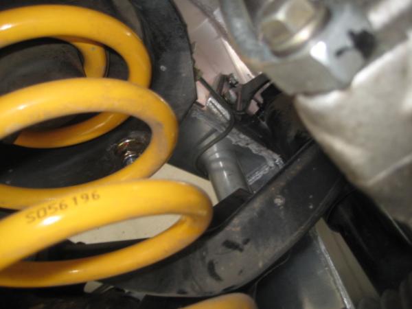

Cobra Make, Engine: DRB 540
Posts: 90
Default brake lines
Old 11-03-2010, 05:22 AM
paul68's Avatar
Join Date: Feb 2009
Location: Mount Isa, QLD
Posts: 90
Default brake lines
couple of photos hope they help

Ok, The owner has had a call from MVR and from what he said all is approved to build, we are going to get his VIN number tomorrow and work commences on Saturday.
I have been advised by Wazza to fit the brake pipe work first (hard lines) Does anyone have a picture showing where the routing goes under the body?
I think it is mainly the rear ones (showing where to fit tab for flex pipe) I will need an idea on as I can see pics showing the front and I managed to take a pic of Paul's car in Isa showing its location at the front.
Pics of progress after Saturday.

dave my early build cd shows the brake lines run like this hope this helps
