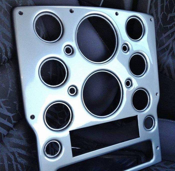

And the central section was a problem....I was trying to do something in fibreglass, then metal sheeting....and Scotty reckoned he could make it out of craft wood ...well some product that is similar anyway.
Some careful and skilful work with a hole saw ,and various tools,by Scott.... then finishing off by Des the painter.....and it came out looking like a bought one....
then left the suitable space in the dash padding, so that it fits "flush"with the leather.....a lot of rooting about,but with the black face gauges and chrome surrounds...and a black backing plate, behind the toggle switches , yet to be fitted...
I'm hoping it will look how I "dreamt it up", about 4 years ago.
These are the sort of things that do your head in, when after all that, they can sometimes look crap....but so far I'm happy with it.
Cheers, Warren

Hi Geof,
Just another pic of that instrument panel.
Picture taken outside the paintshop...when I picked up the panel from the painter.
I couldn't get over how an ugly old bit of craft wood changed when it's all been smoothed and painted.
And yes...
It will simply screw into the nutserts fitted on the dash....and should fit flush with the leather and padding.
Warren
Warren
Looks sensational. Actually looks like pressed metal. Great finish. Craftwood, you say. Hmmmmm.

Warren
That console remindes me of a UK kit layout - ERA was it??
I've certainly seen photos of a concentrated layout very much like that from an 80's kit maker in a book somewhere.
Is that a part source of the layout inspirations?
I do think it looks quite smart though.
Good work mate.
Slo
slowy
Old 12-12-2012, 07:14 PM
Wazza's Avatar
Join Date: Nov 2006
Posts: 1,683
Originally Posted by stephen low View Post
Warren
Good work mate.
Slo
Hi Slo,
When I upgraded the interior of my first Cobra, I had something a bit similar, which I was used to looking at I suppose..
And, one of our clever club members ( A select few you might say ), Phil Aish, made a centre console from fiberglass, which I thought looked pretty good, and different to the usual layout...
Anyway...I had been mucking around with this idea for a while (YEARS ), and had always been told it would look s'house...then Scotty found a sheet of something similar to craftwood...a bit harder than craftwood I believe...and he had a go.
After we painted it the same as the centre stripe, and drowned it in clear...it looks how I want it to look...
Hopefully , when the whole thing is finished it will "fit in"...
If not...
I'll come up with something else I suppose.
Warren.

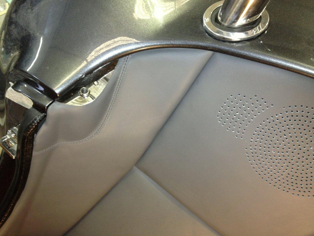

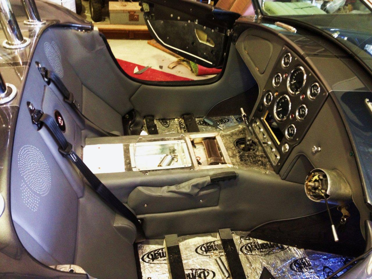

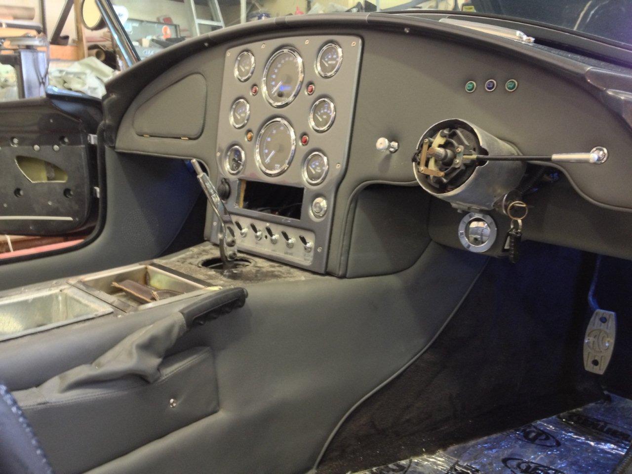

Progress being made..
Sorry that the quality of the pics is not too good..
I'm just using the phone...
There will some be better shots taken , once I've finished it all.
Updates from this morning.....
Back panel all done,
all speakers hidden, and "hide away" panel in the middle...
Central panel opens to a couple of shelves, and the centre console will be padded to come up to almost the bottom of this panel....
Trimming around the cover made to hide the bracket for the bows of the soft top...used a bit of mirror stainless to tidy it up.
Front speakers also hidden behind the trim......
A bit of mucking about to make a panel to mount the "vents" under the dash...these are fresh air , and also heater vents.
( They are actually just a chrome sink fitting, that opens when you click/press on the middle of them.)
A very simple , but tidy idea from Scott Hampson.
All seems to be coming together...
Centre console, boot(Trunk), and carpet on the floors....then it's all done.
Warren.
