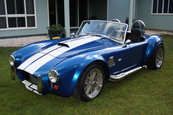

In about a weeks time, I hope to have the Cobra registered and ready to take on a few test runs. As I am the third owner of chassis number 9, it has been a long road for this build. I have had it for about 2.5 years but due to a very busy work schedule, decided to ask Warwick to finish it to a stage where I could get it on the road. Thanks goes to Warwick, Peter Hancock, Harbourtown Paint and Curumbin Trimmers who all did a great job in putting it together. The 4.6L motor is from a Mustang (was fitted when I bought the chassis) with a Tremec gearbox, Voodoo blue paint and Halibrand replica wheels.
The first QT inspection was in mid December and I had to trailer the Cobra to Gladstone (2 hour drive) but almost didn't make it. On the highway, I was overtaken by one of those 'wicked' backpacker vans who must have been checking out the car as he pulled out in front of a Commodore trying to overtake us both. So for a few hundred metres, there were three of us abreast barrelling down the single lane highway - very nerve racking. The Commodore stopped a couple of k's down the road and gestured furiously as the van went past who amazingly stopped as well - I kept going so not sure what happened.
The inspection required about a half dozen minor issues to be resolved before sign off so this has given me a chance to go over the build carefully and make sure everthing was ok whilst carrying out the fixes.
So hopefully, everything will go ok on the 1st Feb and am planning to make a couple of trips to Brisbane this year for a club breakfast or two. Also greatly appreciate the forum and other club members comments and ideas.

Looking good and well done Derek. Hope we can meet up soon!

Looking Great!

Nice car Derek. You can't go wrong with that colour/stripe/wheel combination - the classic look! Keen to see some engine bay and interior shots when you have a chance.
All the best with the inspection.

Looks sweeeeeet Derek, Good luck

Well done Derek. Looks great.
How old would the chassis actually be? Are there any major differences over the later Harrisons? More photos please.

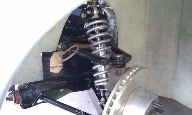

Sweet Derek. LookS nice! Have you got the original harrison front A arm set up being an older chassis or is it the newer DunnyDore front end pov pack?

Bruce, he means "Commodore Poverty Pack" - have you already forgotten how to speak 'strayan?
Mine is chassis #78 and has VS Commodore lower arms and subframe with fabricated upper A-arms. Here's a photo, sans calipers...

Well done Derek, Mine is Voodoo Blue with white stripe as well. I get lots of great comments on the colour. I am sure you will too. Have fun driving.

Thanks, very happy with the finish - under the skin is nothing flash but I hope to add a few personal touches, tidy up the underbody and engine bay paint etc over the next couple of years. The main effort was put into getting it on the road.
Not sure how old the chassis is but the manual was printed in 2001 so it would be about the same. Warwick has added the extra gussets and front cross bar that the latter chassis have but am not sure on any other differences. Rear end is Skyline and front end is Holden HQ (A arm setup) Larger brakes were also fitted.
Paint is also Voodoo Blue which I decided on after seeing your pics Gregg (thought I was far enough away to be safe) and have also had several positive comments on the colour. The picture was taken on an overcast day and looks better in the sun. I think there is some pearl in the paint as well.
