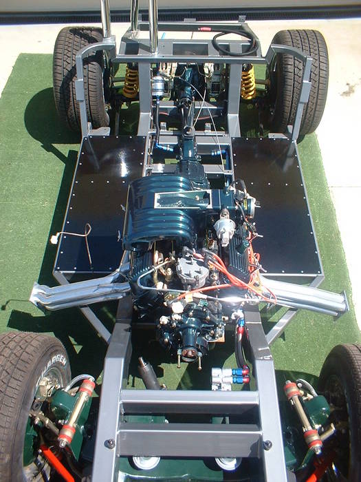

I can tell you that it has Jag front and rear. With the front end using a shortened jag cross member. I thought that RCM was the only one that used the jag cross member. That makes me wonder if it is an RC Sports Cars kit.
Anyone seen the old RC chassis?
As for testing documentation. In NSW this is an issue as the RTA are starting to ask for seat and seat belt anchor testing. But as far as i know the only test you would need in Vic would be torsion and beaming. Factor in about $1500 for this test. All other tests such as braking, lane change etc would probably have to be done with any kit unless identical to one thats already been tested.
If its cheap enough and the welding is of good quality its worth considering.

Originally Posted by Zedn View Post
RC Sports Cars kit.
I was going to say it looked like an RC.....the welding from Dave was OK
But even now I believe his Chassis are sold without TEST reports!!

This is a photo from his old profile on here.
He is still around, now calling himself Venom motorsport i think. Some people on here have is cars.

thanks zedn,
looks very similar to me
front supports and rails identical
support above diff where roll bar mounts, very similar also
support in the boot looks the same
we may be on a winner.

well guys it is an old venom when they where rc sport car chassis
around 1995 build but only the chassi not thebody
body unknown hope this helps you
ring dave from venom motorsports about chassis tests
rob
