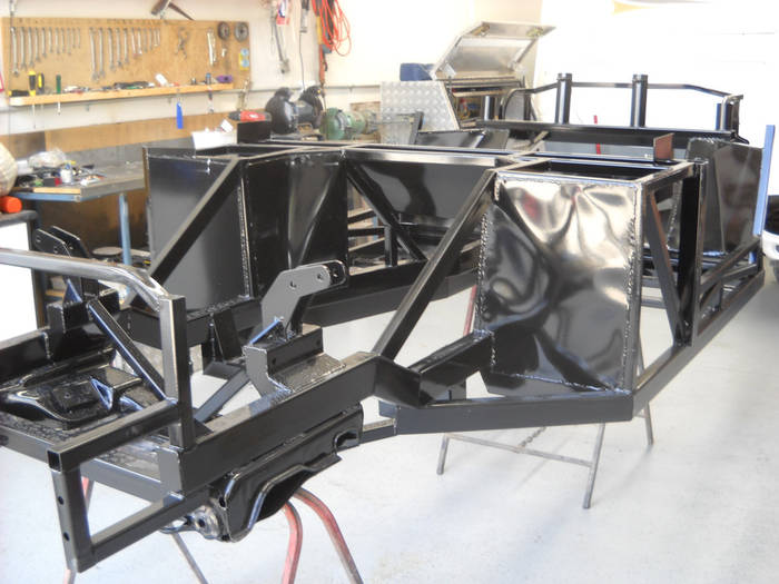

Just a small but awesome update - I picked my car up from Warwick today, and now have it halfway home!
Quite impressed with the workmanship on it, it's all very neat. Got lots of looks from random people on the drive back, and every time we stopped for fuel someone would stop for a chat or to ask me about it. The finish on the fibreglass was so good that one servo guy actually thought it'd just come back from the painters, lol! Guess he didn't see the joining seams still plenty of bodywork to do on it.
My wife's been telling me I'm like a kid in a candy shop right now. Considering the timing, I reckon santa has been pretty awesome to me this year!

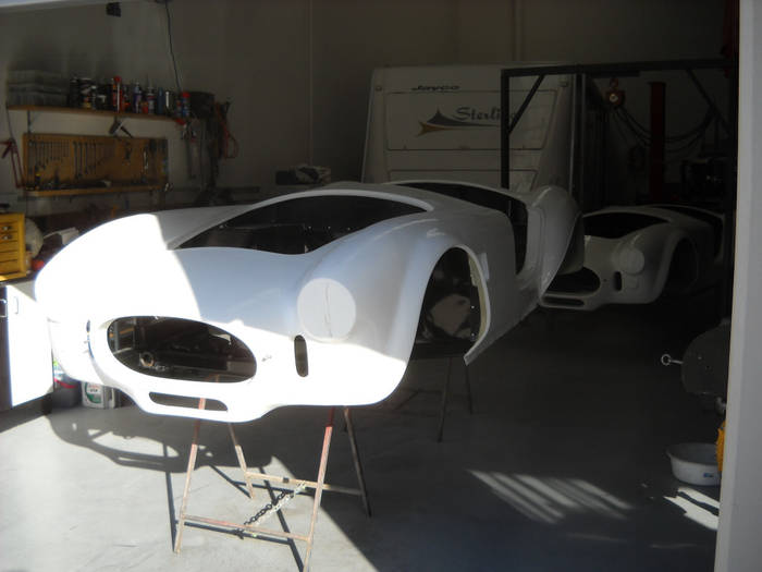

Thanks guys.
Actually, i haven't got it home yet! I picked it up halfway through a 2200km trip while moving house - it's still sitting on the car trailer, teasing me.
I've got lots of plans and ideas though. Reckon bodywork may just be the hardest part, so I think that'll be a good place to start. Then i can do other things here and there as i get sick of sanding, itll help keep it interesting. Might just have to weld up a stand with wheels on it first up though, so I can roll the thing around easily...

Personally Ryder, I would leave the body for at least 3 months (maybe longer) as it will still be "green" and settle in yet.

Ryder, my Harrison is over 5 years old now in original gel coat and there are at least 20 areas where the gelcoat has cracked and broken away over the top of air pockets - mostly around corners, wheel arches and other tricky areas. If you plan on preparing for paint now I suggest shining a bright light from behind wherever you can or using some kind of rolling pin or small hammer to try and find those voids so you can fill them before they give you headaches later.

I agree, mine is now just over a year old and has a couple of spiderweb marks coming through the gelcoat in a couple of places.

There are always a few marks that appear later, no matter how well you prepare. I had mine in a damned hot garage for 12 months being built and also in the sun wrapped in black plastic for some days as well, to bring as many air pockets out as possible. In the 3-4 years since I have only one blemish that has appeared in the paint. Now the odd stone chip is a different matter ...

Hmm sounds like fun.. thanks for the tip, will definitely look for defects like that. The gel coat looks immaculate on the surface.
I've heard leaving it outside in the sun during daylight with a thin sheet of black plastic over it for several weeks can help settle the glass - might look at doing that over this summer. Technically, most of the fiberglass is already a month and a half old, so hopefully it's settled somewhat already...

Other than the fibreglass settling...leave the paint till last. Fitting bits and pieces can scratch and chip a nice paint job. Get every thing done then dismantle just enough to paint.
