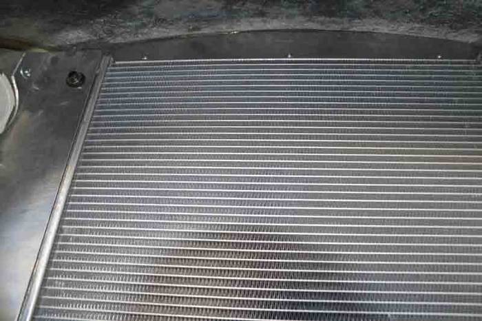

Hi Richard here are some Radiator Pictures
http://www.clubcobra.com/photopost/d...diator_RHS.jpg
Radiator Passenger Side
http://www.clubcobra.com/photopost/d...diator_Top.jpg
Radiator View of the Top
http://www.clubcobra.com/photopost/d...ator_Hoses.jpg
Radiator Hoses View from under the Car

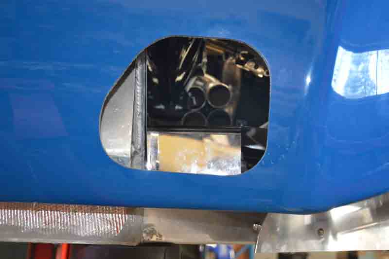

Exhaust Headers Started

Thanks for the photos - all of them are a great help for me to be able to visualise how things go together. Can you also tell me how the radiator is fixed to the chassis along the top? I can see the bracket on to the radiator, but not how it fixes to the chassis.

Cobra01 03-11-2014 08:58 PM
Hi Richard
The radiator piece that seals the top between the radiator and the body is bolted to the raised edge on top of the radiator.
You can see the heads of the screws in the photo.
Brad
RGF 03-11-2014 09:12 PM
Hi Brad,
Sorry - you are right. I meant where does it attach to the chassis. Do you need to drill holes into the cross member that (in your photos) has "6" on the masking tape, above?
Richard
Cobra01 03-12-2014 01:03 AM
Hi Richard
You will owe me a beer for this
On the picture "Passengers side" you will see a piece of bent Aluminium which has 3 button headed bolts that attach the radiator support which has the fresh air intake secured in the piece.
I hope this helps
Brad
Zedn 03-12-2014 01:12 AM
Hi Brad,
My headers are very similar to what you are building there. Just something to check is the clearance for starter wiring. When you add a thick cable there, clearance becomes tight. I was lucky that I was able to get it to fit but if I had the wire in place when making the headers things would have been easier.
Liam
Cobra01 03-12-2014 02:29 AM
Hi Liam
Thanks for the advice I sure will look at the wire from the starter to make sure there is enough clearance.
Brad
Zedn 03-12-2014 03:34 AM
Mine ended up with a pretty big bundle there as it has main battery feed to the starter (0 guage), alternator charge wire, starter switch wire and also the engine oil level sensor wires (ls motor). I ended up with about 10mm clearance so wrapped it with heat shield foil and secured it to the starter with stainless zip ties.
RGF 03-12-2014 03:40 PM
Hi Brad,
Many thanks - that's clear now! I am starting on this at the weekend so your photos and comments will be a great help.
