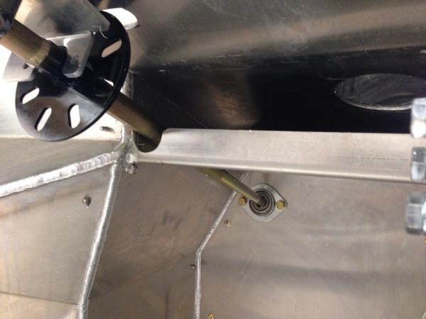

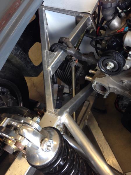

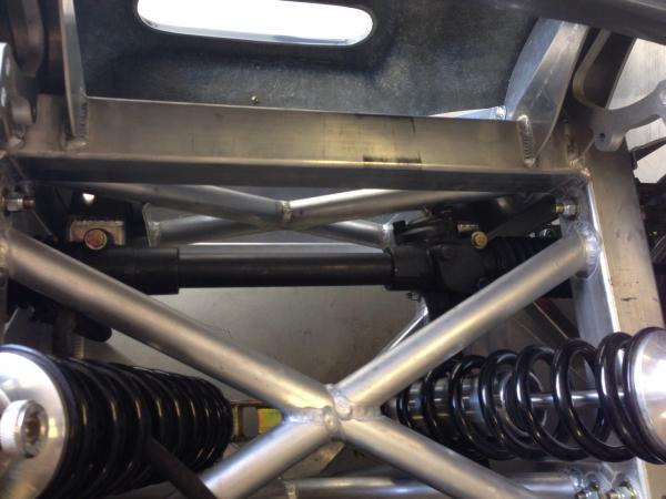

Installing the steering column
Steering rack mounted to the chassis
http://www.clubcobra.com/forums/pict...ictureid=11630
http://www.clubcobra.com/forums/pict...ictureid=11631
Steering column passing to cockpit
http://www.clubcobra.com/forums/pict...ictureid=11632
Steering rack connection to front upright
http://www.clubcobra.com/forums/pict...ictureid=11629
Steering column
http://www.clubcobra.com/forums/pict...ictureid=11633
Steering column with bearings fitted
http://www.clubcobra.com/forums/pict...ictureid=11634
Steering lock fits between the sleeve on the column and the disc behind (more of that later)

Is that a bespoke steering column or from a donor vehicle? I don't see any webbing for the collapsible section - not saying it doesn't collapse, just curious as I'd like to replace my Ford Laser column one day.
750hp 03-11-2014 06:00 AM
It's great to see the details in your photos. Any shot that has a little peak at the beautiful rocker arm suspension is even better!
Cobra01 03-11-2014 02:47 PM
Hi Sambo,
The steering column does collapse It is specially made by Absolute Pace.
From Memory there is a long rivet through the inner and outer shaft that make up the steering column.
http://www.clubcobra.com/photopost/d...ing_Column.jpg
Here you can see the outer part of the column which supports the steering shaft as it goes through the firewall of the car to the universal joint then on to the Rack and Pinion .
There is a bearing bolted to the firewall for support .
Brad
