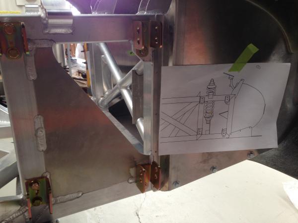

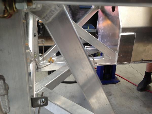

Chassis and Body
3 Attachment(s)
The chassis is beautifully built and straight. Same with the body

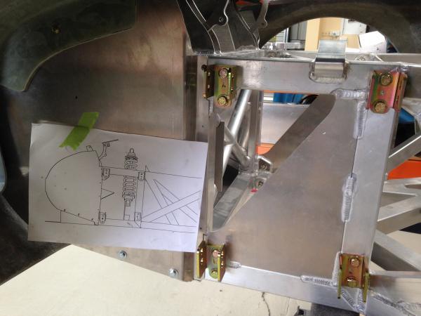

Building the rolling chassis - if anyone wants more detailed photos, let me know
All the parts for the build laid out and ready for me to begin
[IMG]http://www.clubcobra.com/forums/pict...ictureid=11594[/IMG]
First step was fitting the front and rear suspension mounts
[IMG]http://www.clubcobra.com/forums/pict...ictureid=11595[/IMG]
http://www.clubcobra.com/forums/pict...ictureid=11596
Then fitting the front suspension lower mount
http://www.clubcobra.com/forums/pict...ictureid=11597

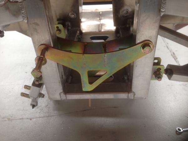

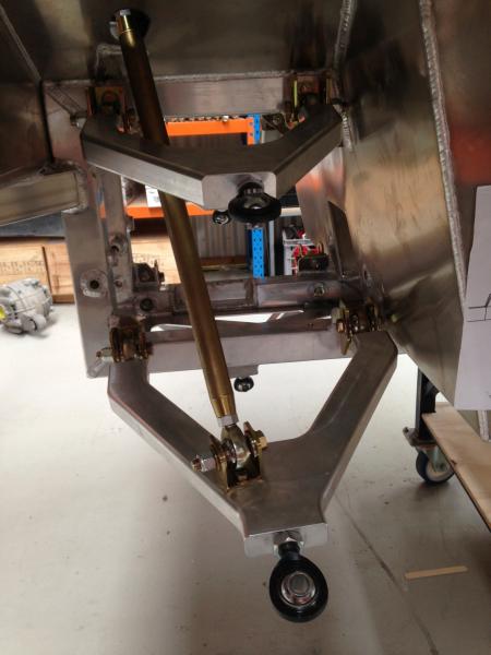

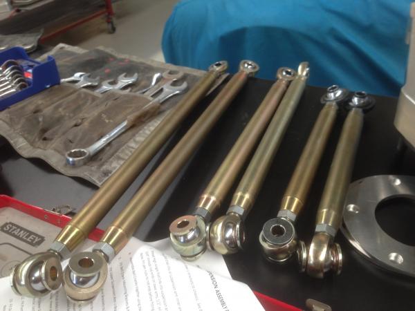

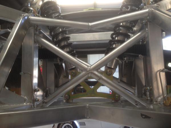

RGF 03-08-2014 09:59 PM
Assembling front & rear uprights
http://www.clubcobra.com/forums/pict...ictureid=11598
Rod ends fitted to suspension control arms
http://www.clubcobra.com/forums/pict...ictureid=11599
Assembling the wishbones & control arms
http://www.clubcobra.com/forums/pict...ictureid=11600
http://www.clubcobra.com/forums/pict...ictureid=11602
http://www.clubcobra.com/forums/pict...ictureid=11603
Fitting rear bell cranks to mounts
http://www.clubcobra.com/forums/pict...ictureid=11601
Fitting rear differential mount
http://www.clubcobra.com/forums/pict...ictureid=11604

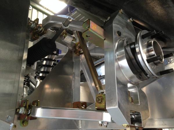

RGF 03-08-2014 10:01 PM

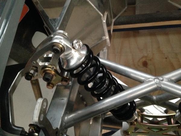

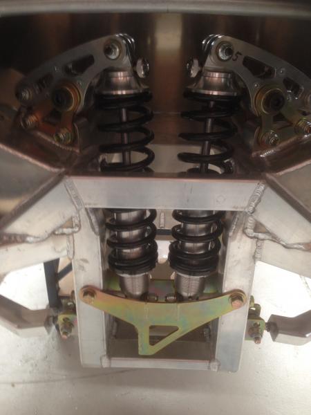

Suspension build
Front suspension completed
http://www.clubcobra.com/forums/pict...ictureid=11605
http://www.clubcobra.com/forums/pict...ictureid=11606
Rear suspension built
http://www.clubcobra.com/forums/pict...ictureid=11607

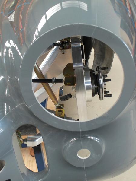

RGF 03-08-2014 10:13 PM
Building the front & rear uprights
http://www.clubcobra.com/forums/pict...ictureid=11608
http://www.clubcobra.com/forums/pict...ictureid=11609
http://www.clubcobra.com/forums/pict...ictureid=11610
http://www.clubcobra.com/forums/pict...ictureid=11611
http://www.clubcobra.com/forums/pict...ictureid=11612

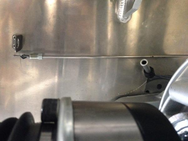

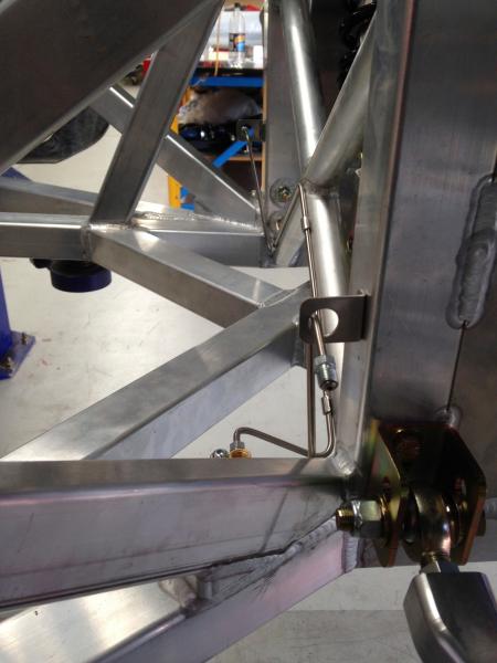

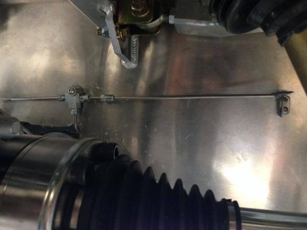

Front & Rear Brake lines
Front lines fitted - note all are pre-shaped/bent so there is no need to shape them to fit
http://www.clubcobra.com/forums/pict...ictureid=11613
http://www.clubcobra.com/forums/pict...ictureid=11614
http://www.clubcobra.com/forums/pict...ictureid=11615
This shows where the front brake lines will meet up with the brake cylinders on the pedal box to be fitted later
http://www.clubcobra.com/forums/pict...ictureid=11616
Fitting the rear brake lines to the tunnel
http://www.clubcobra.com/forums/pict...ictureid=11617
As rear brake lines exit the tunnel. Note that I filed the chassis edge and rounded it slightly to avoid wear on the brake line at this point
http://www.clubcobra.com/forums/pict...ictureid=11619
Rear brake lines fitted (note fuel line is also visible here)
http://www.clubcobra.com/forums/pict...ictureid=11618
