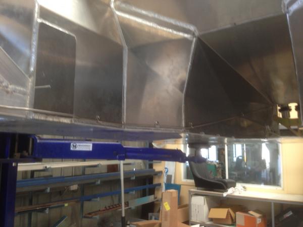

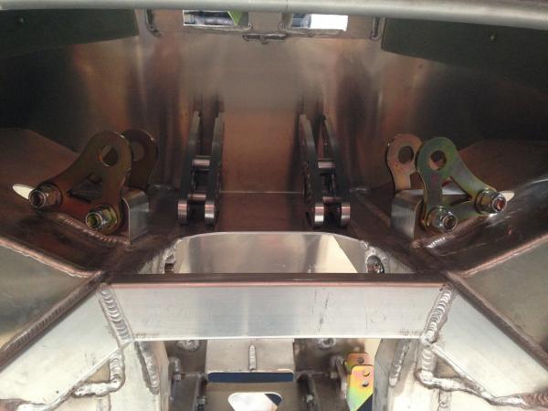

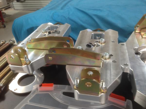

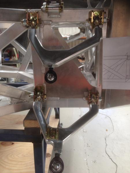

Default Building the rolling chassis - if anyone wants more detailed photos, let me know
All the parts for the build laid out and ready for me to begin
[IMG][/IMG]
First step was fitting the front and rear suspension mounts
[IMG][/IMG]
Then fitting the front suspension lower mount
Laner likes this.

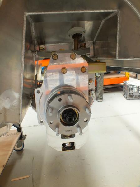

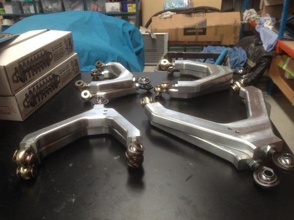

Assembling front & rear uprights
Rod ends fitted to suspension control arms
Assembling the wishbones & control arms
Fitting rear bell cranks to mounts
Fitting rear differential mount

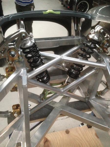

Default Suspension build
Front suspension completed
Rear suspension built

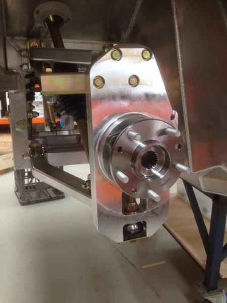

Building the front & rear uprights

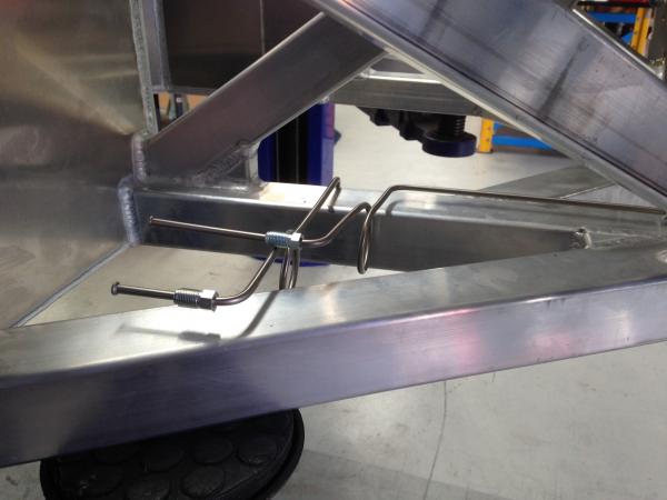

Default Front & Rear Brake lines
Front lines fitted - note all are pre-shaped/bent so there is no need to shape them to fit
This shows where the front brake lines will meet up with the brake cylinders on the pedal box to be fitted later
Fitting the rear brake lines to the tunnel
As rear brake lines exit the tunnel. Note that I filed the chassis edge and rounded it slightly to avoid wear on the brake line at this point
Rear brake lines fitted (note fuel line is also visible here)
