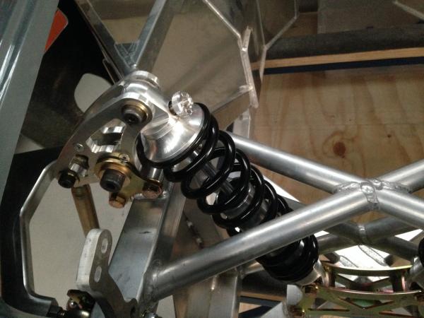

It's great to see the details in your photos. Any shot that has a little peak at the beautiful rocker arm suspension is even better!
Here you go Craig....
http://www.clubcobra.com/forums/pict...ictureid=11644
Richard

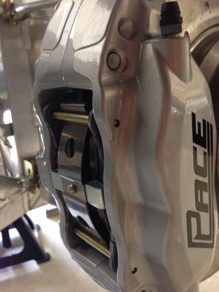

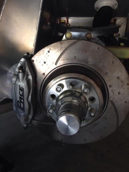

Fitting the brake pads and discs
Absolute Pace brakes
http://www.clubcobra.com/forums/pict...ictureid=11743
Front pads and discs fitted
http://www.clubcobra.com/forums/pict...ictureid=11742
Rear in place
http://www.clubcobra.com/forums/pict...ictureid=11739
Brake pad fittings
http://www.clubcobra.com/forums/pict...ictureid=11741
Brake pad and disc fitment
http://www.clubcobra.com/forums/pict...ictureid=11744
d488y2 03-20-2014 05:23 PM
Nice Stoppers! Are they the bigger Rotors?
RGF 03-20-2014 05:28 PM
Yes, these are the big ones
sambo 03-20-2014 05:38 PM
Those brakes look like the VE/VF Commodore Brembo kits on eBay - rebadged?
RGF 03-20-2014 05:49 PM

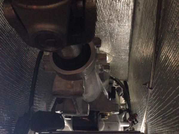

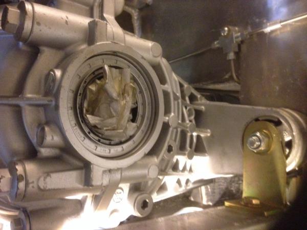

Engine, gearbox and diff
Here are some images of the engine, gearbox and diff. These were fitted for me, by Neil Streeting. He did a great job.
Bellhousing
http://www.clubcobra.com/forums/pict...ictureid=11745
Tremec 6060 5 speed manual gearbox
http://www.clubcobra.com/forums/pict...ictureid=11746
Holden 6.0L HSV VE LS2 engine with wiring, computer, etc
http://www.clubcobra.com/forums/pict...ictureid=11750

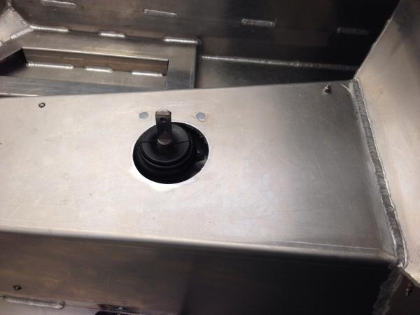

Gearbox in place - note flat underside of chassis
http://www.clubcobra.com/forums/pict...ictureid=11751
http://www.clubcobra.com/forums/pict...ictureid=11754
Gear lever position in cabin
http://www.clubcobra.com/forums/pict...ictureid=11753

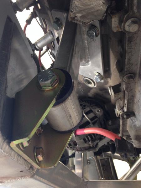

RGF 03-20-2014 05:56 PM
Engine mounts
http://www.clubcobra.com/forums/pict...ictureid=11755
http://www.clubcobra.com/forums/pict...ictureid=11747

The gearbox in the picture looks like a 5 speed TKO 600 to me? The 6060 box is a 6 speed and is rounder and bigger.
Mal Wood Automotive - Tremec Information
