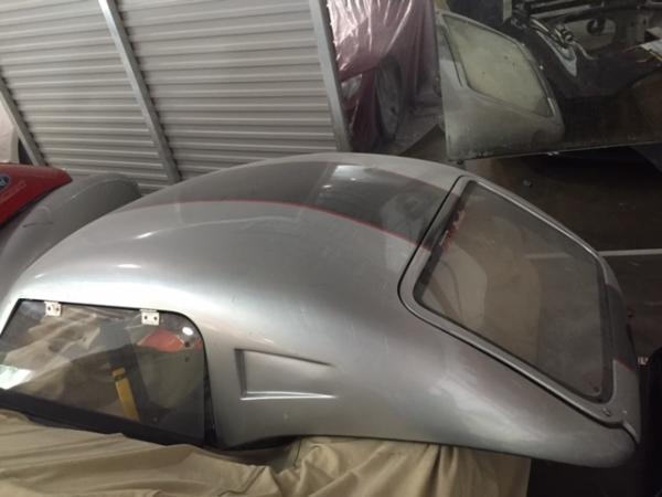

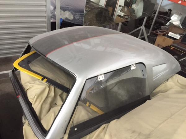

After nearly 12 months of trying I finally have my hard top underway out of the USA. Its a proto BDR built for their track cars. This one has a slightly more upright A pillar and will require some mods to my hoop but not much really and its a bolt in. It will be modded, test fit, internal cage built, then painted and affixed. I have Peter Beehag lined up once it arrives to build me a CAMS compliant cage. Its important to me and my family I get it as safe as I can and I think with what Im doing and plan to do I really want some more protection.
It will run a lexan windshield but no side windows. Rear will be Lexan also.
For anyone thinking of wanting a hardtop for their car and wanted to do a test fit let me know. I'm pretty sure my GB will have been run in and my new trailer going for the Nats but cage and hardtop is probably a big ask. For me to run in QLD Sports Cars I want a hard lid/full cage and before they accept me I need to have run some regular decent times which I haven't yet due to what has been discussed on page 1.
I'd love to run with Ash and Geoff even if Im at the rear of the pack. We'll see.
Ash keeps telling me Im not a player till I race against him so I have much to do. And imagine if I beat him....yep really dreaming now I know!

It should end up like this..

Posts: 1,615
Looks like a good idea to put a top on the Cobra for racing....I would for sure. Plus I like the look actually.

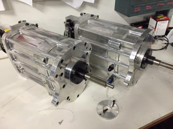

Progress. Well had kittens on Tuesday. HGT emailed me to say that their records showed the Mk2 GB they had sent me and I had swapped out for the Mk1 had been sent back to them. Meaning in short I'd pulled the Mk1 GB, removed all the hose fittings and then reinstalled them on the same Mk1 box and reinstalled it and packed the unpacked Mk2 back to them. WHAT THE! YOUR $HITNme.
I was very sure this wasn't the case but the heart did miss a beat for a while. Thankfully the MK2 is in and installed.
So much so that it now has a working shift counter.
Off to chunks for some re-wiring 16th July.
https://www.youtube.com/watch?v=13Ak...ature=youtu.be
Are you 100% sure Spooky...was it on the left or the right. They look awfully similar to me....
  #56 (permalink)
Old 06-30-2016, 06:43 PM
Posts: 2,752
Thankfully mate the ID numbers checked in the end and also on the Mk2 box, unlike the MK1 ALL bolts are marked with a blue dot to confirm they have been checked and torqued to spec. That was the reason it got changed as their QA process couldnt be sure all was done to spec and with such a new product they didn't want any failures caused by their own fluff ups.
Cant fault their service and quality of product.
