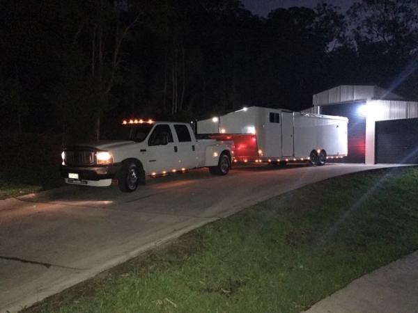

Friday night all loaded and ready for dyno day.

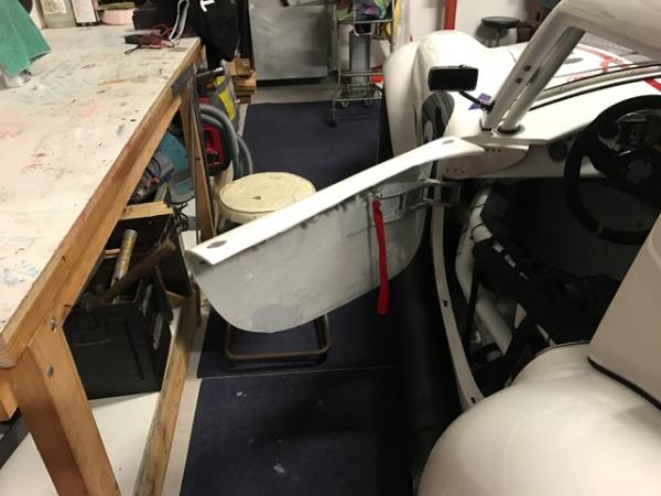

I haven't gone to town on the door hinge as Im running out of time but its fully functional and will do for now. I'll make it visually pretty in the off season. Big thumbs up to WILL from ICCARS who supplied the hinge. Worked a treat!
