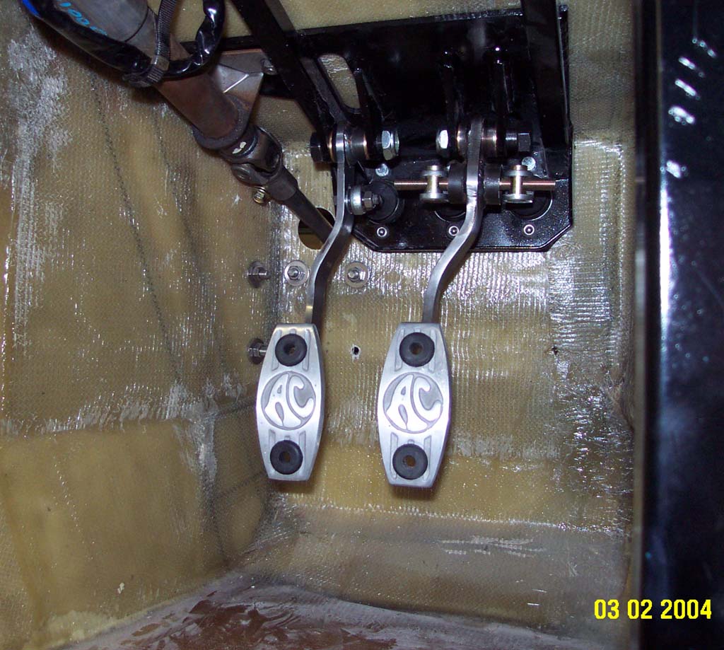

Boxhead, what peadl assy have you used. I have looked but am not sure where to start

Gav,
I used Ians pedals but offset them to the left to give better space for accelerator. Offset was about 25mm which still lets you get your foot behind the clutch pedal when cruising. Ians new clutch is offset at the pivot point which allows rose joint connection to cylinder. Much neater than early ideas.
For falcon pedal ($17.00) slightly modified works ok but I plan to make up fabricated unit which will work and look better.
Mike Murphys gallery has photo of offset pedal arrangement.
Phil

Aussie Mike's Avatar
Location: Sunbury, VIC
Offset pedals,
Here's the Classic Revival pedal setup. I've bent both pedals about 1.5" to the left to make more room for the loud pedal.
There's still plenty of space to slip your foot behind the clutch to rest it on a long drive.
Ian supplied the lazer cut pedal blanks and I machined up the pivots and added bronze bushes. I think Ian does them with nylon bushes from the Falcon but I had a piece of bronze in the scrap bin.
I haven't done the loud pedal yet. I'm tempted to use the Falcon Pedal and modify it. For $17 that's pretty cheap for something that's pretty close to the right shape and it'll make a good starting point.
Mike Murphy
Melbourne Australia
