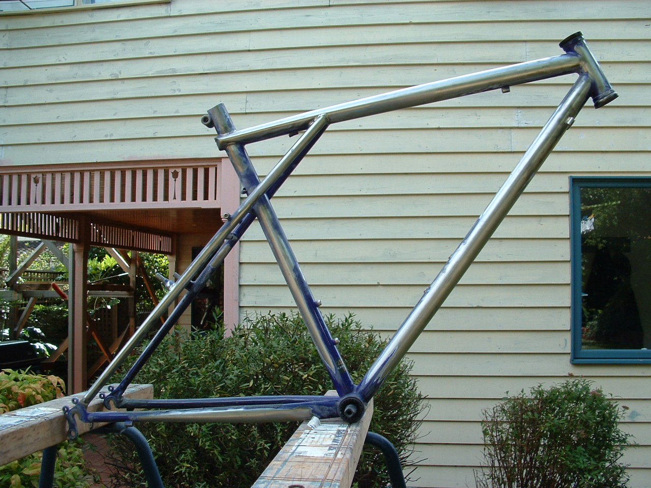

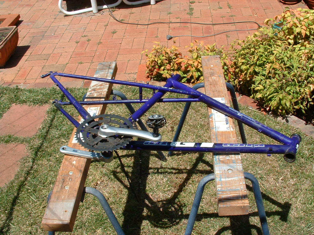

Old 11-28-2004, 09:49 PM
Join Date: Oct 2004
Posts: 62
Thought it was due time that I posted some images.
Before
After
The annoying thing is that I am going to have to a lot of the rest by hand

Old 11-29-2004, 12:58 AM
Adrian S's Avatar
Location: Brisbane, QLD
Cobra Make, Engine: G-Force, 351W, GT40 Lightning Intake, Toploader, Jag running gear, 3.07 diff, Autronic ECU
Posts: 148
Jase,
Don't burn your skin off !! Just get it acid dipped - may take a couple of dunkings. There is a powder coater I use in Bayswater who has an acid bath and he charges very little - quite a refreshing bath too . Best of all, he's open til Saturday arvo and occasionally on Sunday.
Not sure about the clear powder coat option...powder coating is quite brittle and you'll only know you've chipped it when a rust spot appears.
