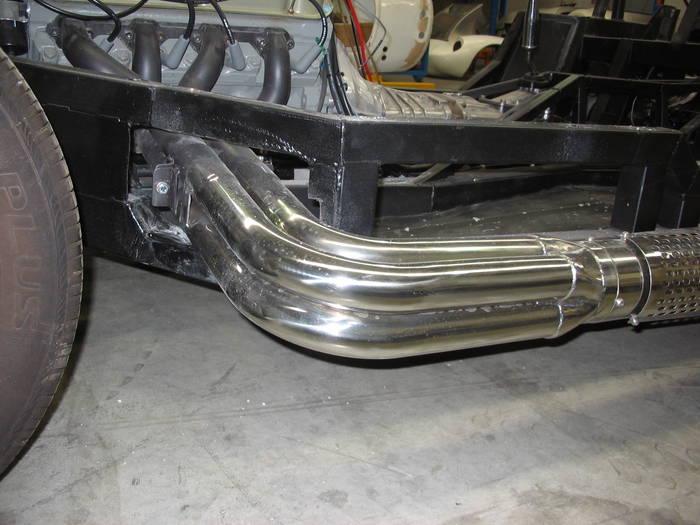

ive already fitted side pipes, i bought some side pipes from usa and cut up a set of block hugger headers to clear the streering and chassis rails, what i thought would be a 1 day job, turned into a 3 day job, a major pain to get the exhaust out through the chassis to the side pipes.

Given you sound like you are fitting live side pipes I'm guessing this point may be of little consideration but the EPA can get fairly nasty if push ever got to shove!
