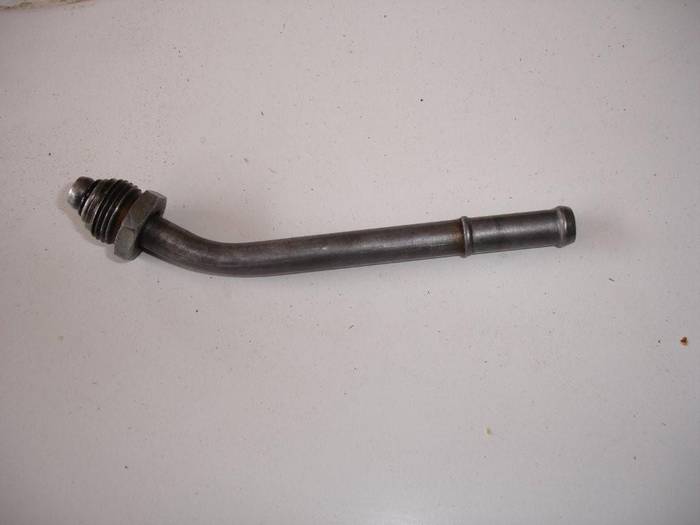

I have a 2008 CR chassis that uses a Commodore VP Power Steering Rack.
I got a guy from ENZED to re-jig my High Pressure Hose which fits just nicely.
My problem is that he didnt have a fitting to go on to the Rack for my low pressure return hose (I have plently of hose but no barb fitting to screw in to the steering rack).
Any smart people out there know where and what size barb (screww thread I mean) I should get?
Also one other technical thing I wanted to check. My engine is from a VY Commodore and came with the high pressure hose/fitting and after modifications just screwed in to the steering rack nicely. It screwed in to the smaller sized hole which I assume is the "input". I assumed the low pressure return would be the larger hole? i.e. low pressure more volume/expansion etc?.

Lastly - I understnd on the production VP the return hose winds its way around a bit for "coolin" reasons. I was not thinking of doing this and just having the barb fitting go straight in to the flexible hose and then to the reservoir.

Gday Gregg - they tend to have 2 sizes on these fittings. On the VL rack im pretty sure the inlet is 16mm x 1.5, and the return is 18mm x 1.5

Still not 100% sure which hole size is which, but on the VL rack the fitting furthest to the right (drivers side) is high pressure, and the other is return. And VP could be different....not very helpful, sorry.
EDIT - just checked my notes and it looks like your OK - (outer one )16mm) is the high, and the return 18mm is the hole further inboard.

Any ideas where I could get a fitting to suit the return hose i.e. I just need a barb fitting as I have plenty of hose. Other than wrecker or buying the whole return line from Holden?

Went to pick-a-part today and pulled a part of a VP commodore for $1.
