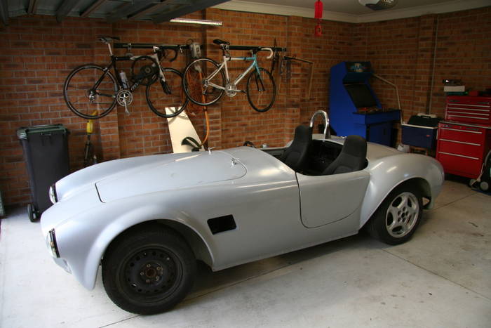

sambo 07-07-2009 06:31 AM
Brought the car home from Kenmer a few weeks ago and will begin tackling the body wiring this weekend.
For those who never saw the old shed...
http://www.clubcobra.com/photopost/d...2172_50pct.jpg
...we've upgraded! :D
http://www.clubcobra.com/photopost/d...m/IMG_4245.jpg
A new work bench arrives Friday, with beer fridge and various other "man gadgets" ready to go. Happy times! :)

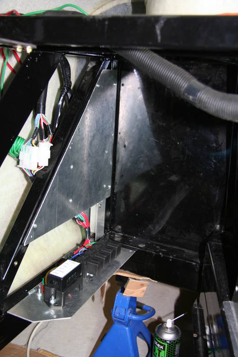

Thought I would share an idea for fellow Harrison builders, with particular relevance to those using Sideshow's LS engine loom conversion.
The photos below show the passenger footwell with two aluminium panels mounted with nutserts for easy removal. The top panel holds the Holden ECU and the bottom section is a swing-down panel where I've mounted the engine loom fuses and relays. It makes good use of the available space and is sturdy enough to mount upholstery at a later date.
If anyone in Melbourne has a right-angle drill I could borrow for a few hours, I'd love to hide that exposed hinge as I have for the other one. Clearance is about 100mm at the lowest point.
http://www.clubcobra.com/photopost/d...m/IMG_4454.jpg
http://www.clubcobra.com/photopost/d...m/IMG_4453.jpg
Merv and Sharon 12-04-2009 04:02 PM
Great minds think alike! I made a fold down fuse box in the same place, even put a light in there to be able to see!

sambo 12-04-2009 10:03 PM

Merv and Sharon 12-05-2009 03:13 AM
No Sambo - it IS a Cobra - I have switch on the side panel that turns on a light in there.
Merv
