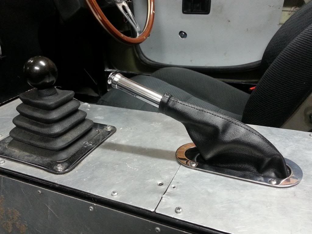

Another nice Kenmer modification - relocated the handbrake from the side of the tunnel to the top/centre and replaced it with a Lokar unit. The gear shifter will eventually move forward with the Aussie Mike conversation that is planned for later in the year.
http://i376.photobucket.com/albums/o...ps163a6494.jpg

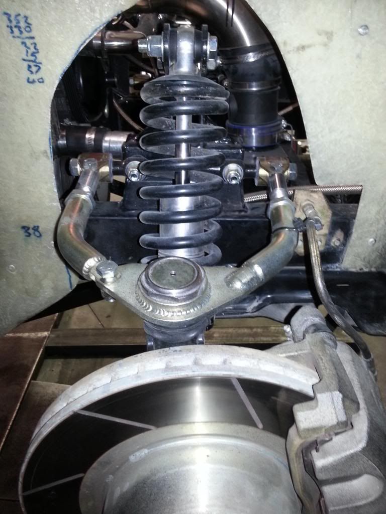

Also fitted some adjustable top arms. Now with 4-5 degrees caster, a lot more "give" in the front springs and a good alignment the car feels ready for some track work - just in time for Winton. Thanks to Marty Govett for all the hard work.
http://i376.photobucket.com/albums/o...psbfdbeb68.jpg

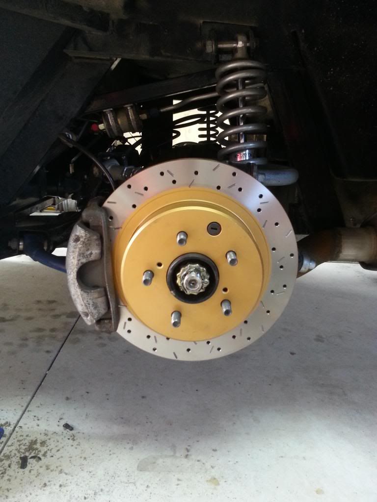

The car has been up on blocks since Shelbyfest. I came back with a spongy brake pedal after running a little too much bias on the rear, probably boiled the fluid. I fitted some new rotors, the pads still have about 9-10mm so I'm leaving those but as a general rule do I need to completely flush the old fluid or just enough to clear the lines?

I too have had the same problem with too much rear bias. Took me a while to get more into the fronts. It was explained to me once that we probably need better back brakes as our cars have near to 50:50 weight distribution and do not transfer much weight forward under braking and hence the rears do more work than in a road car.
How come you changed your rear Rotors?

I have a bias valve on the rear line and it just needs to be closed a smidge. The crappy VZ front brakes barely got hot while the rears were so hot on the 4th run that a chunk of rubber left over from the V8 super cars lodged on top of a caliper and actually caught fire - no kidding either. Managed to blow it out easily enough.
I was still on the second hand rotors from the donor Skyline and they needed machining. I saw those 4000 series rotors on sale for $250 and snatched em up.

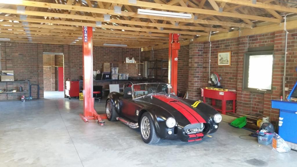

I scored a man cave with hoist, TV, kitchen, toilet, shower and a few other goodies (still unpacking).
http://i376.photobucket.com/albums/o...ps06cec80a.jpg
http://i376.photobucket.com/albums/o...psc4dc227d.jpg

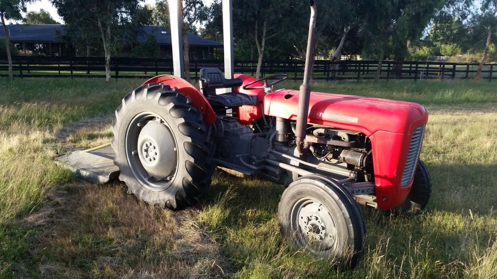

Plus a 1957 Massey Ferguson 35 which I have become attached to. It seems to have had a pretty easy life so I'm considering a full restoration if I can manage to go without its services for a while.

The Massey 35 looks like a ripper. Looks to be in really good shape. I've spent a fair bit of time on my friends Massey 35. You wouldn't believe some of the places I've driven it in and out of on his property (I didn't believe it myself at the time) He has a farm on the side of Mt Tennerife which is pretty steep in places. Great tractor.

stripes look great I have a vinyl cutter of my own for doing the stuff on our race cars so im going to make my own and see how I go . looks like a nice place you have moved into and like mike ive spend a lot of hours on a massy 35 there a good old unit for sure .

Great job, are those front upper arms from Harrison or another supplier?

That's an awesome set up, and there is sooooooooo much that can be done there as well.
What's the coin op on the right?
It just does not get much better, car on a hoist, do some work, sit on couch watch tv, grap beer, practice that trick shot (pool) to astoun our mates, back to hoist.
Man heaven.
I just noticed ..... The bar fridge is to small and also around the wrong way, and no upright alloy sheet tight bend pole (stripper pole).
Both the can b attended to in due course.
