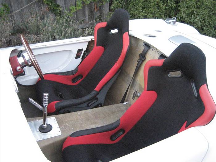

This is my new gear lever, that will sit on my modified T56, It looks familiar because Mike did the "lever forward", conversion for me and designed the knob! Can't wait to change gear for real, instead of in my lounge room, Thanks again Mike, your attention to detail is amazing. Peter

Thanks Peter,
I could make all sorts of comments about how its comfortable to hold or that you get a good grip on the knob but I think that'll just get me into trouble.
Needless to say the shift is designed to put the gear lever closer to the steering wheel so that it's a reach across rather than a reach down to a conventional shifter location.
I got the idea as Mando guessed from the shifters in the V8 Supercars. I've been running a similar shifter knob up in my Cobra and it's great on the track.

Yep,
The shifter relocation comes with the shifter shown and a billet knob. I've got a few different knob designs I've made over the years. I can machine something custom if you want something different, within reason of course (machining veins into it would be a bit tricky) .
I've done a few of this style with an AC or a Cobra logo in the top.
The knob threads on and it locked in place with a grub screw in the side. Makes it difficult for some one to steal it.

With the remote factory lever removed, don't you lose spring plate that centres the shifter into the 3-4 plane when you knock it up out of 2nd or down from 5th?
My chassis doesn't allow for the shifter to be mounted directly to the box like Mike's mod so we're working on grafting the remote setup forwards the position displayed above. It will point backwards instead of hanging off the back of the box. I've also bought a short shift kit (eg, Harrop style) that should remove some of the factory vagueness.

Hi Paul,
Why won't your chassis let you put the shefter there? Is there a cross member in the way?
The new shifter has a spring setup in it that I shim to suit. It keeps lever centered over the 3-4 gate. I can dial it in for much spring tension there is as well as the ofset left or right.

My engine/gearbox is 'ergonomically' too far back for the direct shifter position (as we'll call Mike's setup), so moving a crossbar won't make any difference. I spoke to Ripshift about a reverse handle on their popular shifter but they couldn't make it reach forward enough.
All this is pretty frustrating, because we've actually moved the engine forward about 50mm on the mounts, so it was never going to work in the direct position. I think some of these Harrisons have a bit of variation in the way they're setup. By the way I did speak to Warwick but it's hard for him to troubleshoot from interstate - besides, we've dealt with it now.
See pic below for further clarification. The black gaffer tape is where the direct shifter goes and you can see that it's almost at hip level to the driver. It wants to be 4-5 inches further forward. If you can imagine the whole thing another 50mm back from what you see in that photo, that's how the kit was delivered. NQR.
