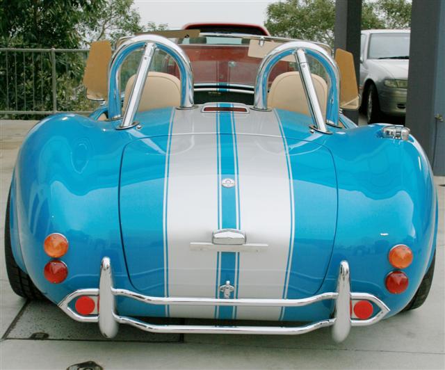

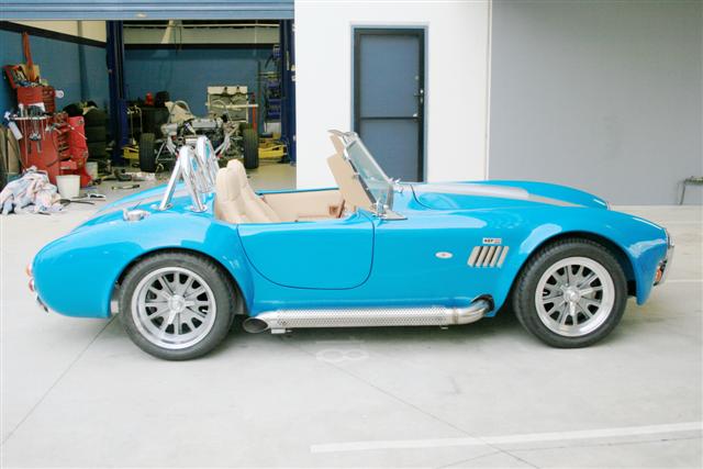

The car is almost finished. Drove it for the first time yesterday. I had to take it to the local weighbridge as I have emission tests with the RTA next Wednesday. That was the first time it has been on the road and gave me a huge thrill. Cobras certainly create a lot of attention.
I hade an EVO 7 trying to bait me as well as another goose in an R8 showing me how well he could light up his rears. Is this normal behaviour when you're out cruising? I had a couple hanging out of their cars taking photos. I don't know whether they were taking them of me or the car and I had quite a few drift over into my lane as they stared at the car instead of concentrating on the road ahead.
There are still a few minor issues to work out in the electrical department, have to do some re-aligning of an idler pulley and the suspension settings need adjustment. Other than that, everything went well.
Hope you enjoy the pics. By the way, it came in at 1,242 kgs with 72 litres of fuel on board.
On the weighbridge.

Wow, your car is beautiful, excellent color combo/contrast. Its very common for other vehicles/drivers to want to mess with you, these cars are magnets. The best part is you can pick and choose who you mess with. Sometimes ignoring people is as powerful as responding to them.

Car looks really nice Baz, I like that colour leather with the light blue. Must be a thrill to take it out on the road for the first time.
Maybe its just the camera angle, but it looks like the passenger side seat is slightly crooked? Probably just my eyes.

Youv'e got a good set of peepers there Liam. The seats were only installed temporarily so I could get it to the weighbridge. A bit of work to do on the mounts next week so they have to come out again,

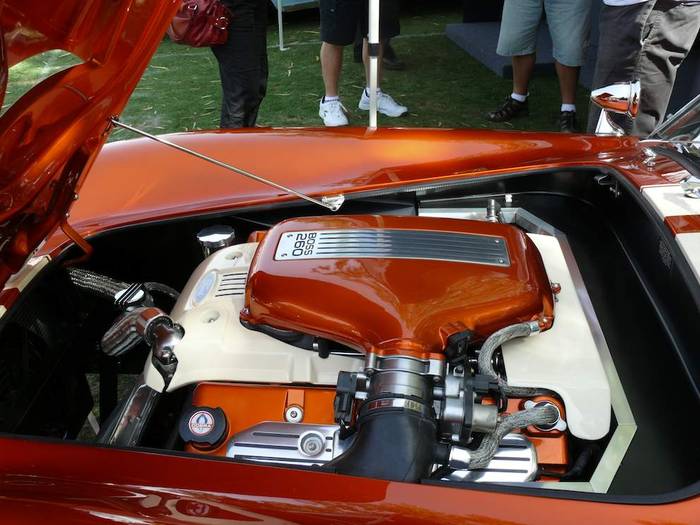

Nice motor you have there Baz. I saw another one at the Noosa Classic Car Show.
