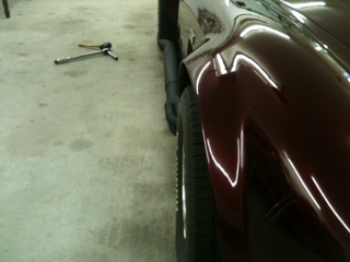

I have my rear end and rear wheels and tires taken care of. Looking to get the Team 3 AC III wheels to match for the front. Im using a set of the 5/8 narrowed tubular mustang 2 front upper and lower control arms with a set of the 11 inch brakes and rotors. What backspace and width should I use in the front as well as tire size. The team 3 guy I spoke to said 7" rim with 4.5 backspace, that sound right? I dont want the rim too far in and Id like to run a 8 in the front if possible. Also what tire size for the front.
I have these ACIII s for the rear 15x10 for my narrowed 8.8

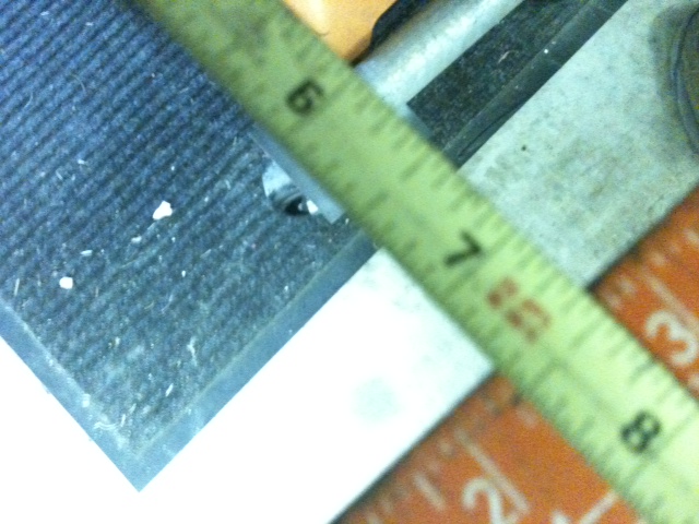

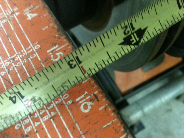

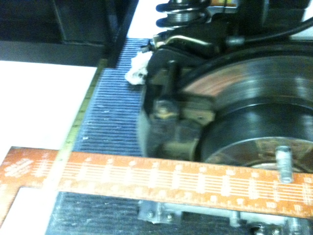

Ok, here's the measurements from mine.
I am running 15 X 7 and 4.5 backspace with 235/60/15 on front.
Also running 15 X 8 and 4.5 backspace with 295/50/15 on rears.
From frame to face on front is 12 7/8" and 7 3/8" on rear.
The rear is slightly tucked in on mine so it could come out a little. If you are running 10" on the rear, yours will most likely stick out a little.
I had a rub on my drivers side that I had to fix so you don't want to go farther in.
