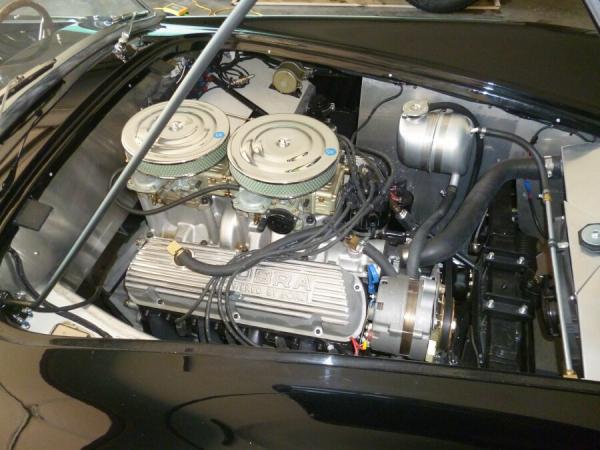

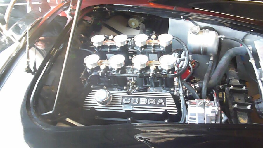

I was running two 4/b's on a high pro 289 , car was way over carb. Put on a eight stack easy tune system, totally changed the car, love the EFI would never go back.
Eight Stack Injection- 289 302 347 Systems
