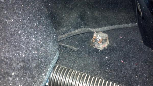

If you have adjustable coilovers just increase the ride hieght by adjustment of the springs. If your running the original coil spring set up, they are adjustable by screwing the upper spring perch up or down. There should be access to the top of the spring perch, which has a hex top, through the package shelf behind the seats. May be covered by carpet. Or new coil springs at a different length. Good luck.

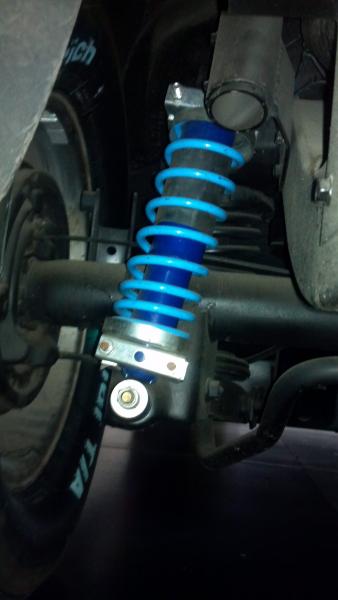

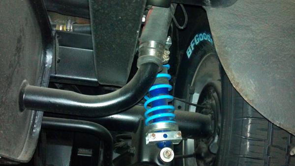

John: Here are some pic of the shocks that are on it now and the Bolt adjustment you mentioned. You cant see it but there is a set of springs in front of these shocks directly above the rear axle. As far as the adjustable bolts, the one on the passenger side is screwed past the shelf about an inch and the drivers side is out of the shelf not quite and inch.
I would like to increase the rear end height an inch. With the new tires it looks like it is high in the front end and low in the rear. I do want to upgrade to the QA1's but its not going to happin for a month or 2 at least. What shocks did you use when you did your rear end upgrade?

I have been out of town for a few days enjoying the 115 degree heat in St Louis. It looks to me like you are using a coil over shock now, and your still using your coil springs. When I put the coil over shocks on my car I removed the coil springs. They were on a perch sitting on the lower control arm not the axle. Anyway the coil over shocks have an adjustable ring that screws up or down to raise and lower the car via spring compression. I'm not sure how yours are built but perhaps you could raise the bottom spring perch on your shocks to get a little more lift.
I purchased through Classic Roadsters, just before they went out of business, the coil over kit, but it came from Pro Shock. Figure out your ideal ride height (bolt to bolt) for the shocks and contact their tech department for a recomendation and buy them direct. Im sure you could do the same for the QA-1's also. I wasn't comfortable with the single shear attachment (remember I don't have coil springs to support the car) so I modified that in my lastest project to strengthen the assembly. Let me know if you need more info, happy to help.

Sorry that was a type-o on the tires. fronts are 265 50R15. Same size that was on there before. I took a measurement of the old tires and they had about 1/2 less tire in the rear than the new ones do. Because they were close to being bald. The car is parked now till I can get around to installing new shocks front and rear. Because I'm getting a little tire rub in the inside wheel well on the rear passenger side. Also on the same the spring in screwed almost all the way down on the adjustment post. But the driver side is screwed all the way up. So it looks like the rear passenger side spring is shot. I will not replace these springs just do the coil-over package.
