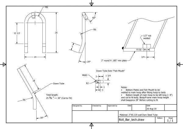

I recently bought a pair for my CR I, I plan to fabricate up and cross bars to make these work and be properly functional. I will tell you it is going to take a bit to make them work, but the ones from Shell valley are very well made. I went with the raw steel since I will be fabricating things. If you need some exact dimensions from them or anything please hit me up and I will snap some photos.

Uploading images failed here so I threw a few in dropbox. Once I get my design complete for the mounting braces I am designing I will post those too
Here is the dropbox link : https://www.dropbox.com/sh/8fi9jka4q...sz0V7khta?dl=0
I will take a few more pics later and add to the folder also.

look around in the threads, there are dimensional drawing for the roll bars. f not 'll try to find my copy, hidden somewhere in many files, hahaha

drawing in this thread: Looking for Roll Bar build sheet

Hey all, I cleaned up the drawing a little.
