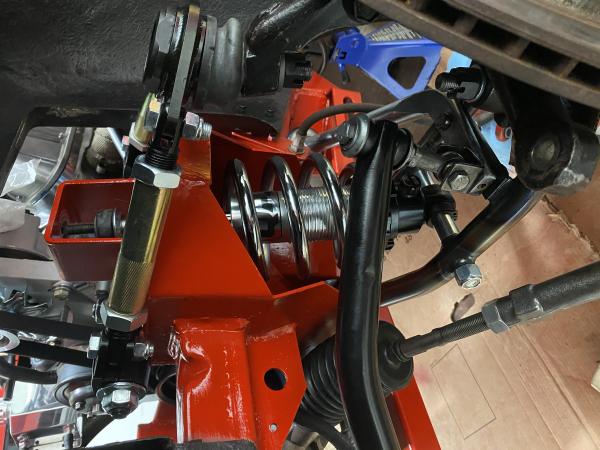

My heart sank last night as I tried to install my QA1’s and nothing is fitting.
I’ve read over the other suspension posts, but didn’t see links to the parts. Can anyone confirm that these are the correct QA1’s? The specs look good to me. Apparently all I need to do now is cut down the top mount bracket from 3” and re-weld it at 0.5”. That I can do.

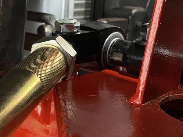

However, when that problem is sorted, I also have issues with the upper control arm: it’s contacting the frame/spring perch on its downward travel, I think the adjusters are too wide to clear. The originals kind of kicked out and bent back in. Are there specific UCA’s that are meant to work with these cars better than others? see picture...
Here are the parts I’m trying to make work.
LCA:
https://www.summitracing.com/parts/hdt-ca-102-m
UCA:
https://www.summitracing.com/parts/sps-94000
QA1’s:
https://www.summitracing.com/parts/qa1-ms302-08375
I can modify the U bracket down to 1/2” and see how things fit.
I’m hoping you guys have some input. Thank you very much! I really don’t know where I’d be without the collective help of everyone on here.

These UCA’s look like they might clear better...
https://www.summitracing.com/parts/s...g-ii/year/1977
Yes, those should probably clear. They come straight out from the cross-arm before bending toward the ball joint.
Brian

I seem to recall there's a longer version of the QA1 shock to fit the CR extended upper mount - but not in a Mustang II kit. QA1 technical support is quite good and can help you sort that out.
If you choose to keep your current shocks you can attach shock extenders to the threaded stud to provide additional length.
https://www.summitracing.com/search/...ze/3-8-x-24-in

Bryan: THANK YOU! You just saved me a ton of work. Shock Extenders!!! That’s brilliant.
I’ll see if I can return those UCA’s I got. Shipping back from Canada might not be worth it though.
Cheers!

Thank you for the info! Once my replacement UCA’s arrive I’ll give an update on how they fit. I guessed and went with the 375 springs as most said their ride was too stiff. Got the Mr. Gasket shock extenders to add a few inches so I didn’t have to cut and re-weld the upper U brackets! Thank you to the fellow who told me about that!!!!! Also a thank you for letting me know about the speed bleeders for the brakes- grabbed some of those too. Genius!
One thing to note, which surprised me and I’ll mention this to QA1 when I have a chance: the lower 1/2” eyelet is 85mm in length. The corresponding opening on the LCA to mount it into is 83mm. Not sure if that mistake is QA1 or Heidts, but the parts don’t fit together without modification. Just 2mm per side to grind off, but not something you should have to do really. Not a huge deal, just found it odd and had me second guessing the parts I ordered were the correct ones.

Im not quite finished- just waiting on the Wilwood kit, so I haven’t driven it to confirm everything works yet.
But these are the parts I used...
LCA; https://www.summitracing.com/parts/hdt-ca-102-m
UCA; https://www.summitracing.com/parts/sps-94800
* these seem a bit tight still. A non adjustable set might clear better. They seem to kick out a bit further and don’t have bulky adjuster nuts to cause clearance issues. Also the ball joint boot is a horrible design on this product. I wouldn’t recommend it on that alone. When installed it folds in half and it just does not seal properly. Re-installed it 4 times and I’m still not happy with it.
QA1’s; https://www.summitracing.com/parts/qa1-ms302-08375
*I went with the extender- seems perfect but will know more after it’s on the road. This set allows you to keep the Mii design without modifications to the frame.
Spanners are NOT included; https://www.summitracing.com/parts/qa1-t114w
Spindles; https://www.summitracing.com/parts/hdt-mp-028
Brakes; https://www.summitracing.com/parts/wil-140-10440-dr
I’m using the stock sway bar. Yes, it is an overkill. Other people on here have just removed it entirely. Most of a harsh ride however will come from a spring rate that is too high. So I’ll see how it drives first.
