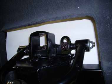

[IMG][/IMG]
Passenger side looking toward engine. Bracket is tight against the shock tower.

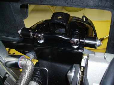

[IMG][/IMG]
Another view from the same side.

I hope that who ever views this thread will grasp an understanding of the installation of these brackets quicker than I have. Thanks to all who contributed to help me understand my problem. Especially Terry Crist, who reworked my two (same side, and incorrect) brackets to give me two mirror image brackets.
