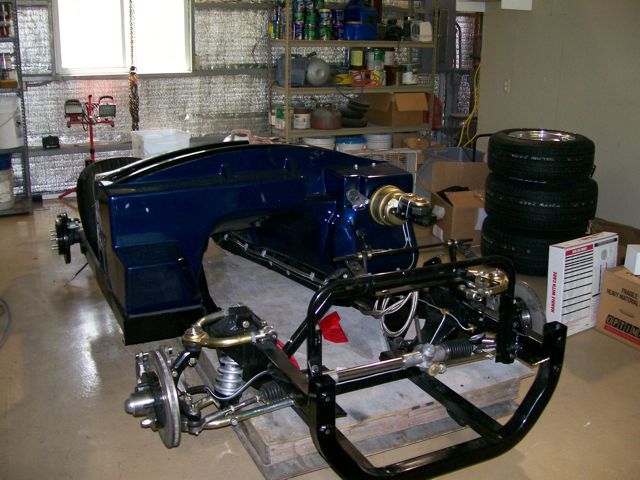

capteddie 06-08-2008 10:25 AM
Stopped by DVs on Saturday to drop off the body.
Here's some of the progress being made :D Thanks DV!!!!
Body loaded up and ready to go...
http://www.clubcobra.com/photopost/data/500/Body_2.jpg
Another shot of the body with the tires and wheels...
http://www.clubcobra.com/photopost/d..._and_Tires.jpg
Here's one of the chassis...
http://www.clubcobra.com/photopost/d...Chassis_1a.jpg
One of the front suspension...
http://www.clubcobra.com/photopost/d...pension_1a.jpg
A shot of the rear end...
http://www.clubcobra.com/photopost/d...ar_end_1a1.jpg
A look at the dash area...
http://www.clubcobra.com/photopost/data/500/Dash_1a.jpg
Getting closer :D:D:D

Double Venom 06-08-2008 12:24 PM
This is how you do it when you work alone...........
Ed, not to worry, already pushed the frame underneath, cut out the doors now will mount it to the frame. Good having you here for the day!
http://www.clubcobra.com/photopost/d...n-ist_time.jpg
DV
PS. Looks better than sitting on a trailer-hey?
