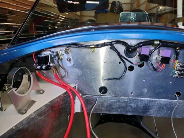

Thanks Glen. We lengthened some wires and relocated the solenoid in order to install the puke tank.

Originally Posted by CCKW353 (Post 1482269)
since when did ERA start installing purple relays :eek:

CCKW353 10-29-2020 03:26 PM
No idea on the relay but aren’t they cute ;)

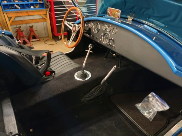

CCKW353 01-02-2021 11:17 AM
Some more work was done....
Tunnel installed including e-brake and shifter boots.
Installed drivers seat, adjusting rails and harness.
Finished all the wiring and no issues except the hi beam relay doesn’t work well, got another one coming.
Today I will be doing the passenger seat and harness so interior is all but done.
CCKW353 01-02-2021 11:19 AM
http://www.clubcobra.com/forums/pict...ictureid=19318
