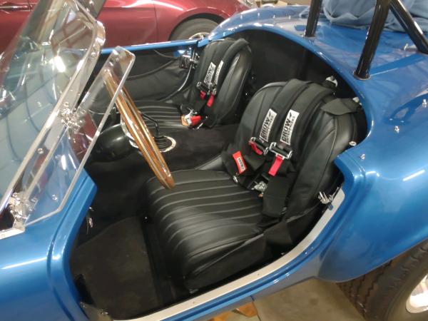

The final list of things to finish is shrinking. Worked out any issues I had with electronic gremlins, finished up most on the engine bay, had to pull thermostat to better position the weep hole, replaced my water temp gauge since it worked only once, have hooked up the carb linkage (just need to fine tune it), installed the tunnel, passenger seat and harness. So things are going good but slow since the weather is cold now in PA. I need to still install the puke tank and rubber lines related to it.

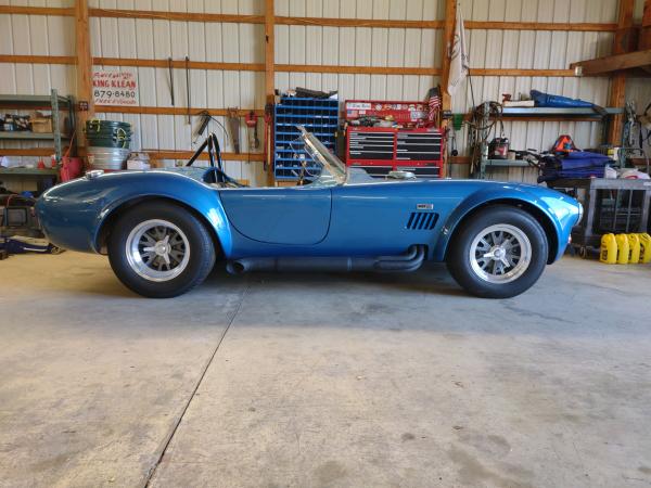

This is how it sits fresh of the jack stands with the drivetrain in it. I will be adjusting the final height it will sit when it hits the road. http://www.clubcobra.com/forums/pict...ictureid=19365

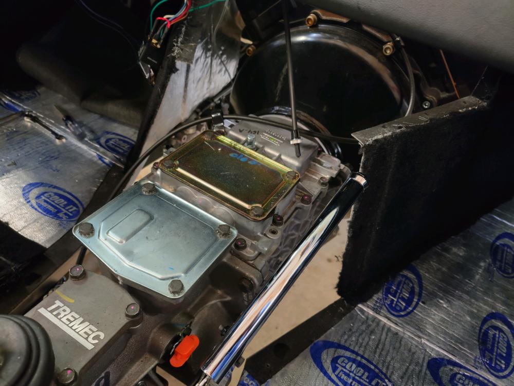

Seats and tunnel pulled for the swap, figured why not do it today. A fun Sunday.http://www.clubcobra.com/forums/pict...ictureid=19403
