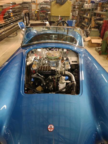

After some painful weekends, the tranny and motor are in... two photos of what things look like now. Hooking up things and getting ready to fight with the pipes and headers.

The shine on the car allows you to see the rafters... ha! It looks real nice in the natural light but now a lot heavier to push and I no longer can fit under it.
