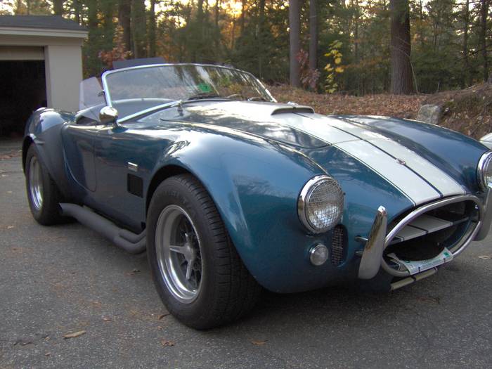

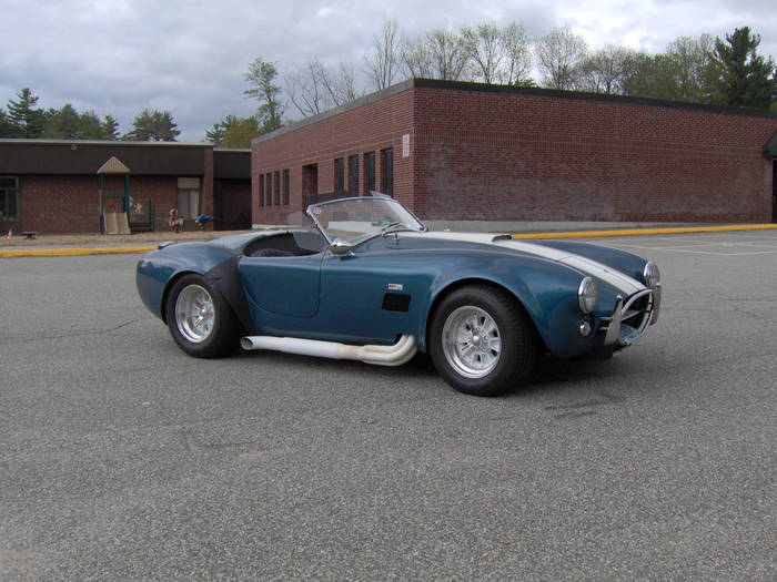

Compomotives white:
Compo's in Black:

Hi Jeff:
Many thanks. Nice looking wheels in both black and white. Mine are black. Shouldn't be a problem from here out.
