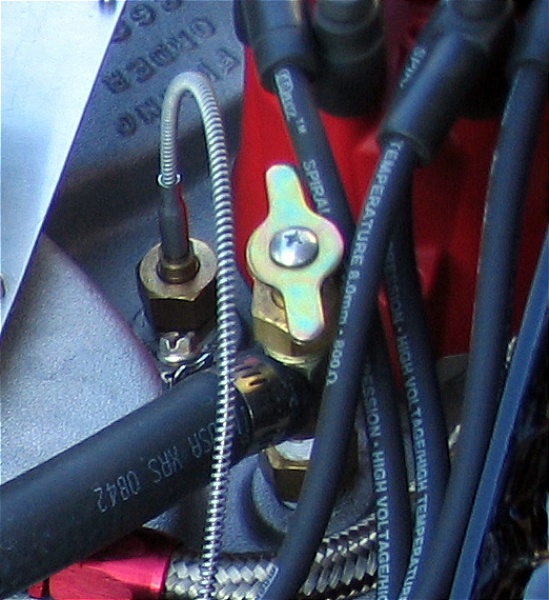

Perhaps there is a third port? I do seem to recall having to deal with some kind of plug at or behind the distributor? The water port directly behind the thermostat is used by the water temp sensor, which I don't really want to mess with. That port would normally be the supply of hot water to the heater box inlet. The water pump outlet is a no brainer of course and is the return of hot water port.

So, Ernie are you saying that you do not have both of the fitting holes you see here?

Rick, I think that is right, hot water from the motor, not from/after the radiator. It APPEARS that I have a second port beside, behind or nearly under the distributor, mostly it's covered up by the front carb. Gonna be real tight getting a fitting in there. I might move my temp sensor to that hole and use the temp sensor hole to the intake side of the heater, through the heater valve first of course.

Any chance you could post a nice photo of what it is you're dealing with?

Had a bite to eat and the couch grabbed me by the ankles and threw a half nelson on me. So I staggered to the garage to take this fuzzy picture of what must be a "water port", I hope.

That's where I have my temp fitting. See my shot above.

Oh yeah, I see it now! OK, thats the plan, move the temp sensor to the new hole and use the current temp sensor hole for the heater fitting.
